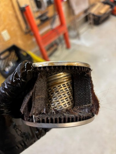

Any cutaways like we see with so many filters on YouTube? Wanna see the media

Do they have 100% spun glass or synthetic? paper just isn't the answer imo, to each their own on that one. Every extended paper filter I cut open 6- 12 months was stiff as a board with a hole or several in it. I don't even care if it is chinesium, so long as it is glass, for my preferences. How much of a paper filter's life is in permanent bypass? Never have to ask that one with glass. Forget about the micron meter in bypass, mise well not put a filter on it, good flow anyhow.

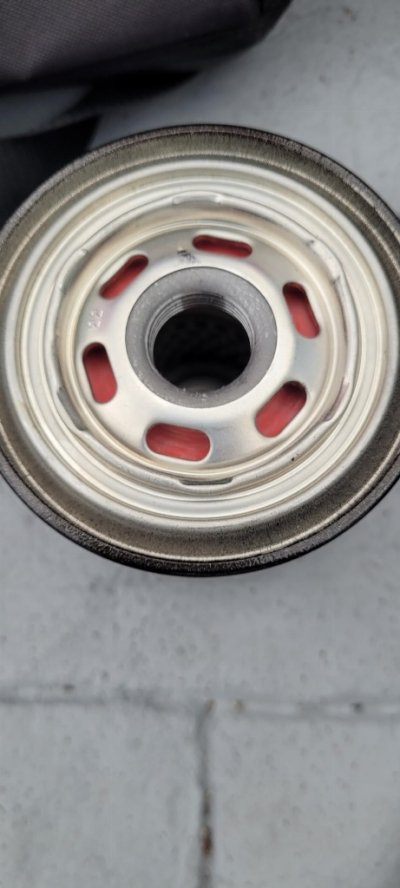

oh yeah look at these babies...
That looks like syn both of them.
idk if Fleetguard Mexico plant improved quality or not over time, at least it's Stratapore glass media. IDK what else to do anymore. The STP video is 7 years old. This resupply situation is moving in real time. Donaldson doesn't make a syn media for midsize, anyway. In fact, I can't get one for my tractor hydraulic system this spring - they're out with no availability date.
