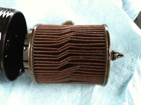

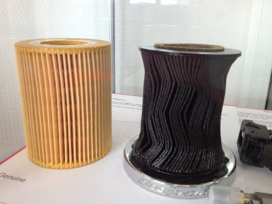

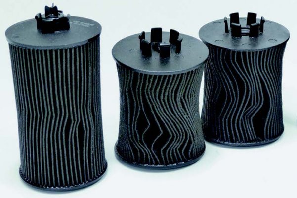

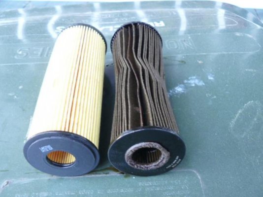

You know what is missing in the bold statement by mahle, the media itself causes the collapse when it stiffens up. When the oil cycles cause the paper media to bind, it simply does not filter no matter what anyone at bitog says. So unless you blow a hole through the media, or the bypass works perfectly, you get a vacuum effect that collapses the media. At what point do we decide it is just irresponsible to your truck to use a paper filter? Save a couple bucks, can literally kill your cam with the issues known to the 5.7.

With synthetic media?

try spun microglass next time?

Yeah you should, when filter look like that they just arent filtering. Let us know when you try one.

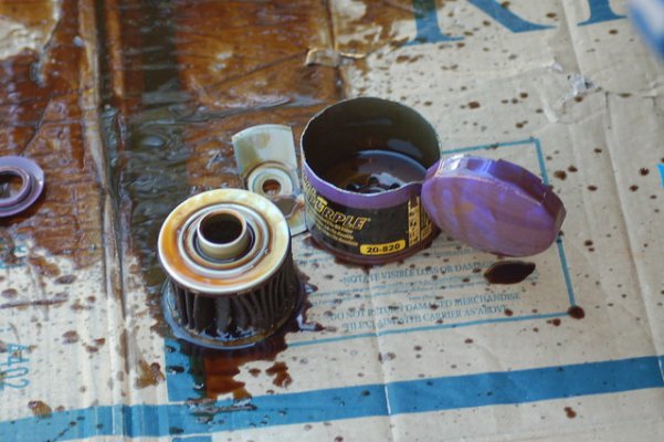

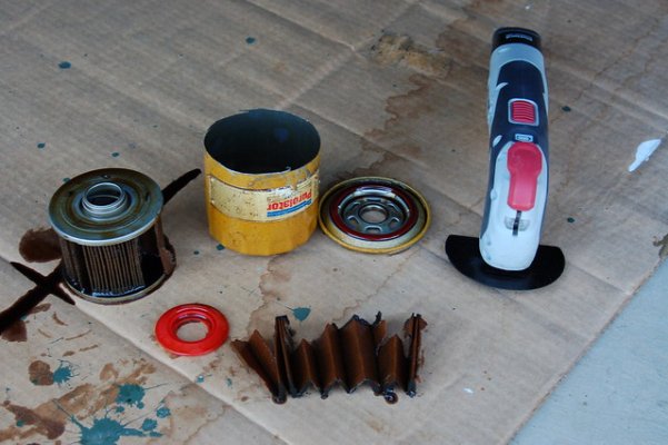

I just use my osculating tool cutting wheel. It would be neat to have a oil filter cutting tool, but there is just some things I can allow in the never ending budget requirements. It's a little harder to do the RP ones, but most other filters it cuts like butter, lol.

That second pic looks like what the 3.6 filter looks like after an oil change....
I have changed no less than 30 oil changes on 3.6L using mopar filters and never had one come out twisted like that.

I dunno worked for me, but the RP was a little more hard. Once it gets through just follow the cut comes right off with the wheel cutter shown. But those were both cut with that osculating tool. Those compression ones benefit from having a vice, did you have it in a vice?
