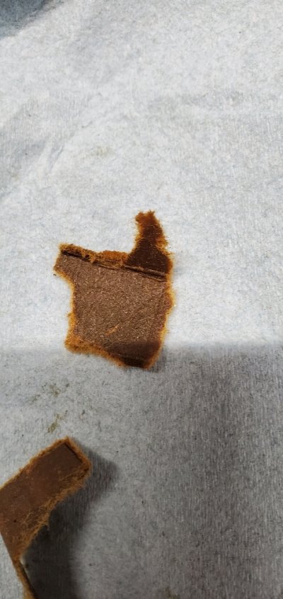

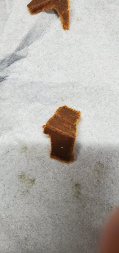

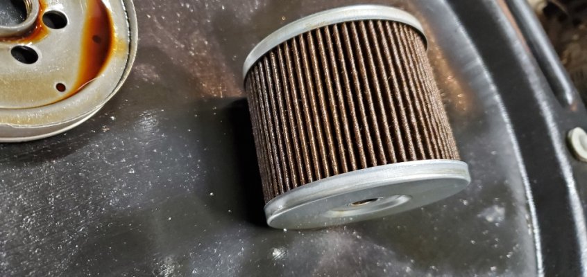

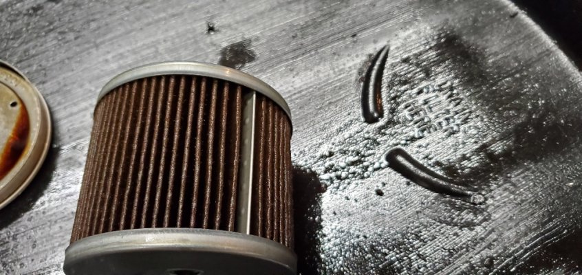

So I did my biannual oil change today to my winter oil of RL 0w30. I had been running a SRT filter since April and about 4000 miles.
The SRT filter I had assumed was synthetic media but I wasn't sure if it was spun microglass like the RP/Amsoil/XP filters. I cut it open and I see what looks like paper media but in remarkably good shape for 6 months/4000 miles. The pleats are still perfectly straight like a synthetic media filter would look like.
At @Burla s request I cut some of the media and pulled it out. It's still very pliable and not stiff or "crunchy" like every paper filter I've seen is like. For example the filters for the 3.6 is a cartridge filter and the pleats are all wavy and scrunched up. The media is very stiff and not very pliable at all.
Heres some pics of the SRT filter I cut open today and a Mopar 339 I had cut open a few years ago.5cbe5bcf12e1b7bfe16d64c5ab304248.jpg500a5f1aa702ecee2e4f493f6482e02b.jpg8e7a92276c8b6e6de1044b335dcb5998.jpga7c49619eaff87ba35fc2dcba1bc74f3.jpge54e45e3782e75dddf7a772e9a5db8e0.jpg

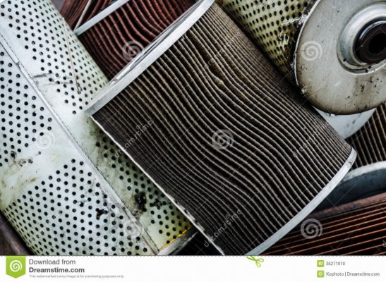

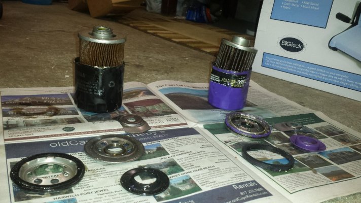

And we noticed some paper filters look like they have been vacuum sucked compared to spun microglass that doesn't. Looks like the vacuum moved the pleats, as if bypass is either not working or creating some vacuum. I can't imagine that is good for hemi lubrication, having that restriction or oil being pulled through a vacuum with the media as a big ol obstruction... So now that I think about it many times I have seen this diagonal movement on paper filters. I have cut open less of the spun microglass, but I have never seen this diagonal pleats that look as if it went through a vacuum or something like that. Just think about how bad that would be at lubrication our lifters at start up, to have a vacuum effect laboring to get oil through the pleats.
Notice pleats paper versus spun microglass, this is a new subject we haven't covered before.
Zoom the paper mopar filter.
srt synthetic..
Random filter

So if I’m understanding correctly, the Mopar filter is paper and has fallen victim to the “vacuum effect”, while the synthetic media royal purple stayed firm and didn’t create a vacuum effect.
I also look at it that the synthetics not caving to the vacuum effect may not even be truly “filtering” much as the debris is freely flowing vs the paper ones that may actually be truly capturing all the flakes. But I do see the logic behind the oil may be struggling to get through the media thus starving the engine and/or creating that initial loud start up.
I do recall my fist oil change the Mopar one did catch a bunch more little metal pieces that the RP doesn’t seem to catch..Can’t recall if there was a vacuum effect on either of them though.
But if the Mopar filter WAS (probably not anymore) designed for the Viper, then it should be equally suited for our engines, thus should be among one of the best filters for our Rams?
And now I’m trying to think how both the above examples would play a role with oil pressure. Mopar filter my idle PSI was I think 40s maybe 50s? But RP is real low to mid 30s..

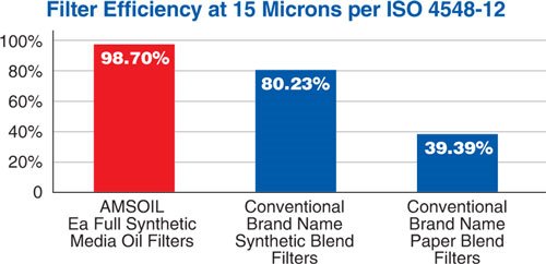

Just didnt feel like making another post, so back to the forum favorite...
What does Ea Mean?
Absolute efficiency (Ea) describes filters that pass the muli-pass (beta ratio) test with a contaminant-removal efficiency rate of 98.7 percent
I guess someone from Amsoil can't spell, ea is a mis spelling, it should be AE.
From amsoil on the amsoil ea/royal purple filters, thus why we see the patches so clean, and this is at 15 microns even lower then the average 20 micron ratings we usually see. Also, you see why there is better flow and better filtration, because of the size of the paper fiber compared to the synthetic, usually you get one or the other, but in the case of spun microglass there is no downside.

So that first part is what the SRT filters are made of?
I know Mahle is stamped on the Mopar air filters....
haha, srt is rebranded mahle. We do figure stuff off around here. Now, how do we compare that against spun microglass? Real interesting stuff though, I'd say pretty conclusive that is what it is. Does one side feel rougher then the other? I wonder how they binded the two medias.
Hemi395
Mar 18, 2013
9,510
17,691
Cape Cod MA
Tore a bigger piece off and the inside (clean side) of the filter is definitely a rougher material than the outside. The outside is much softer, definitely doesn't feel like paper .......

Superior filter media and its processing prevent decomposition and collapse of the filter under extreme conditions such as repeated cold start and high dirt load. Bypass and check valves assure constant oil supply at all times.
That is what we see when we see that diagonal pleats, that is collapsed media under vacuum.
