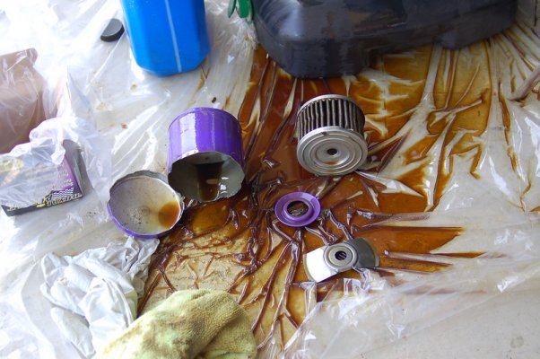

Well, this is a little weird, pdf amsoil filter. Did amsoil change their filter? as we know it is always possible, did rp change as well?
That shows a different bypass the RP, "if" they have it. Corey didn't you cut the 11 open? Damn, I guess I have to go back and see if we have any cut open. I will post my RP filter cut open again. We need guys who have bought amsoil 11 or rp 20-820 recently to cut open filters for the forum. thanks in advance anyone who does this.
I've cut so many filters open I honestly don't remember lol. I know I ran a EAO11 for a few thousand miles but I don't remember if I cut it open....

Corey's data also shows that suspect filter also has a bypass, a little stiffer, but still it looks good. So now my question is did amsoil "upgrade" their filter and the "new" bypass style less reliable then the old type you see in my picture above?
To be continued, we need cut open pics anywhere on the net that shows the new amsoil filters cut open.
