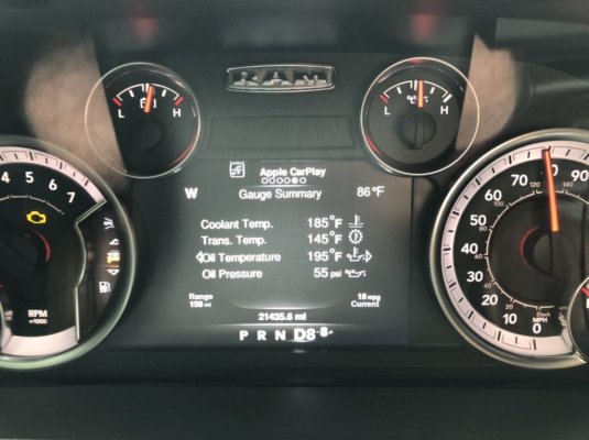

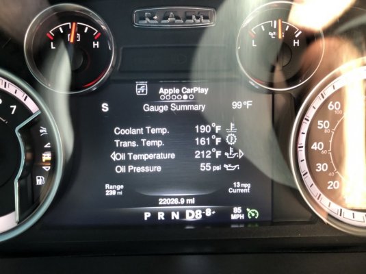

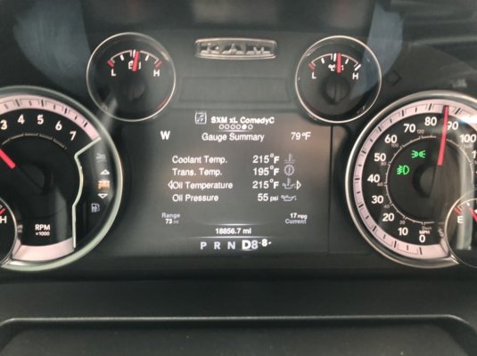

For my last oil change (red line 5w-30), I switched from the RP 10-48 to the RP 20-820 filter.
Definitely took more patience to maneuver the larger filter in place.
Also did some other cooling mods (180* coolant thermostat, AGS delete, V8 stock fans deleted, V6 stock fan installed, trans heater by-pass thermostat installed) so it's not an apples to apples comparison, but no significant change in observed operating pressures.
Before
After
Curious to see if the filter has any effect on extended (4 weeks +) shut off times and first start.
Before
After
Great info, thanks for posting.
And wow those trans temps are lower now, that bypass is a must for 8 speeds....

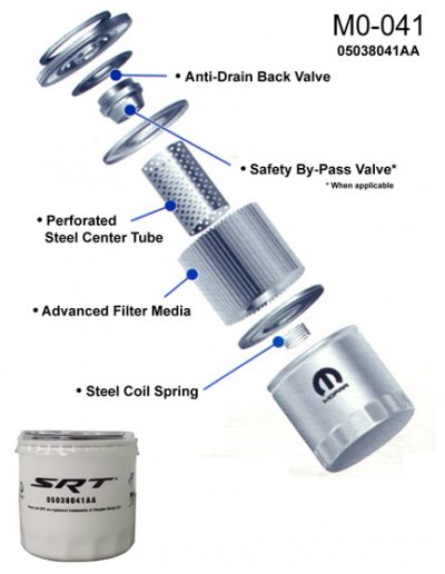

Mopar SRT MOP-05038041AA (data from Summit Racing Catalogue)
Gasket I.D. N/A
Gasket OD. N/A
Canister O.D. 3.650 in.
Canister Height 3.650 in.
*added canister surface area +31.5%

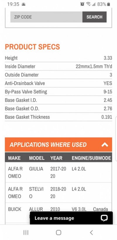

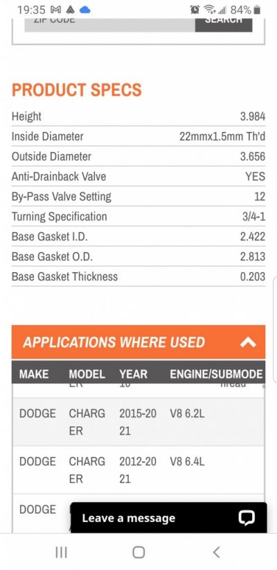

so hemiman got me interested in switching to the xg2. I went to the fram website to compare specs
looked at the xg2 everything seems nice go to the xg10060 (that im using now) the bypass pressure is 9 to 15
how can a bypass pressure be variable? or they just dont know what it is?
seems ridiculous but I know it goes on alot of cars so they want to be vague as possible Im guessing
all the more reason to move up to xg2 right!
One says 9-15, the other says 12. My experience is marketing bulletins are typically sloppily-written by junior people. We strived hard at Cummins to stay on top of it, but relentless budget and people cutting caused us to fall in the same boat.
The published data tells me Fram has a lower set poppet valve, regardless of variability. I would prefer a higher pressure setting on a synthetic filter media because the flow rate should be better due to uniform porosity, as long as there's enough media surface area to provide for enough dirt holding capacity prior to valve opening, or slowing flow to valve train too much.
So, I'm looking for largest canister that's easiest to install, synthetic media, highest pressure relief valve setting. Then changing @ 5,000 miles regardless. A reminder that one doesn't have to be as picky with non-Hemi engines.....at least those without other lubrication problems.

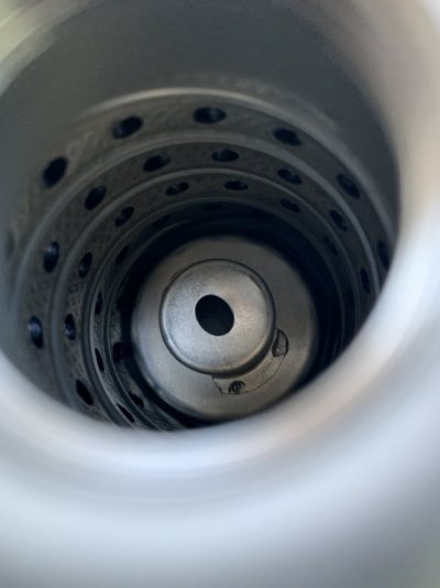

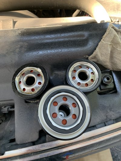

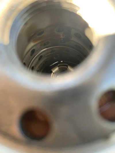

im about to change my oil and i decided to look inside some of my old wix xp filters and noticed one looks different. Maybe its been covered before but its been over a year since i read this thread from start to finish but maybe someone else can better explain to me what the difference is since beyond filter media im as clueless about oil filters as any random guy off the streets.
the new filter is the wix xp 57899 i will be installing today and the used ones are both wix xp 57060. Ill post some pics of the purolatoe boss i used when i get er out

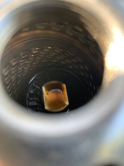

Also noticed different number of holes on each
