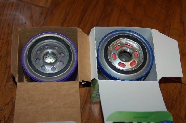

Now, they also say temporary and it is fairly recent, so why temporary? Maybe the latest version, and there was one, has less flow or a different bypass. I had a low restriction filter and it was deadly to my truck, made it tick, and it was puro boss old style, so does it makes a difference? heck yeah it does, this rams are so finicky pay attention. All that was needed that time was a filter change and my truck no longer ticked. When you look at the why, you see the puro boss back then had a very few holes to let oil through. It had nothing to do with the media. I think most filters have went to cheese grater design, which appears to have zero issues with flow.
What once worked on older vehicles sometimes doesn't work on vehicles of today. It is an argument FOR low weight oil though, something for some people to consider.
old rp 20-820 versus old puro synthetic pre-boss.

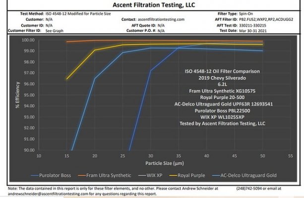

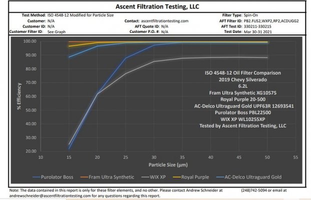

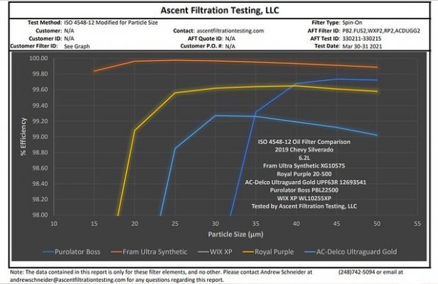

Oh, this is good fellas. Finally we get some answers wix xp versus 20-820 plus we get a new player to the field. Mind you this is rp 20-500, so they didnt test my favorite 20-820, but pretty good info regardless... So apparently there is a place where you can send filters to kinda like a voa. Don't know nothing about this place, just say these posted.
I have posted 1,000 times the difference between wix xp and rp, rp thick loose, wix xp tight and thin, well what a huge difference? I wont ever buy wix xp again, and yes I bought one for my transmission.
I'm eating popcorn, what you guys have to say?

wow wow wow wow wow! Where'd you get ahold of this data, @Burla ?
Is this 'new & improved' Fram Ultra Synthetic XG? It shows best combo of efficiency AND dirt holding capacity. Better than RP!
man I have to give up my sources, lol?
The one place I hate to admit I got it, that should give you a hint. It was in the thread about the amsoil data bulletin on ram trucks.
Very impressive fram ultra against the 500, don't know about the 820, but perhaps similar. Either way, both filters look great just like the GM test showed as well.

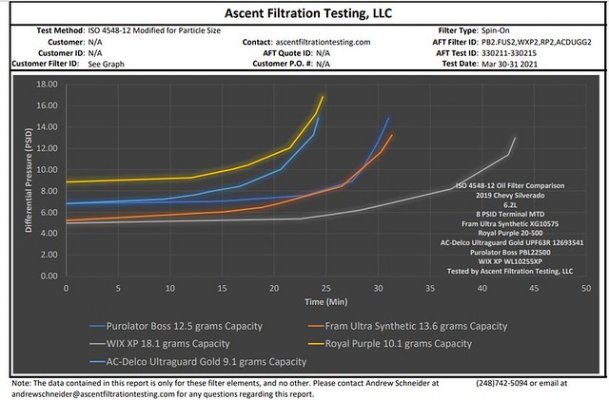

The second one could possibly really help us in choosing filters with psi, I would like to see the rp 500 you like versus the 820. I'm not sure which value is most desirable, the RP is very different then all others, maybe that means not as good, I don't know how to read that. I want to see what that place says on it. heres their website.

You know, it was always 'reported' (BITOG and elsewhere) Wix wasn't efficient for small particles, which of course cause the wear damage on tight machine surfaces. Well, if the data @Burla posted is accurate, that really shows up. It makes Wix nothing more than a rock catcher. Purolator, too.

ac delco ultraguard 24 month unlimited miles warranty is the new player, something I never heard before and looks less then rp or fram ultra. By the looks of it, I'd run it. My wifes car gets fram ultra, after seeing this I will have to keep using that brand.

well, according to this the ac delco is cellulose, so scrap that. Cant be right to have a 2 year warranty on paper filter.
