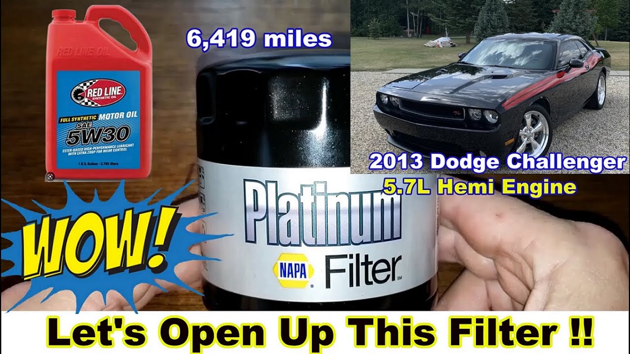

I did one search on YT a week or two ago for the Fram XG oil filter I'm using, and now YT "helpfully" continues to spam me with oil filter videos :boxed:
Anyway, this one came up; Napa Platinum run in a 5.7 hemi challenger with Redline 5w-30. Synthetic wire backed media, silicon ADBV, can is a little weak. Micron rating not known.
Might be worth a look?
Ramerica
Dec 1, 2022
45
110
East Coast
2020 1500 DT
Could be large like 30 microns, Wix makes that filter for NAPA. Then again Wix also makes the SRT filter and supposedly that is 20 microns.
