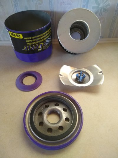

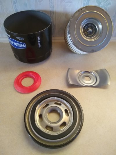

I'm currently using the PUROLATOR BOSS PBL 24651 oil filter but may use the Royal Purple 20-820 on the next oil change.
I purchased a couple Royal Purple oil filters and cut one open to see for my self the quality verses the PUROLATOR BOSS. I'm still not 100% on the plastic bypass thingy in the Royal Purple, overall quality is very good.
PUROLATOR BOSS 24651on the top/Royal Purple 20-820 on the bottom.

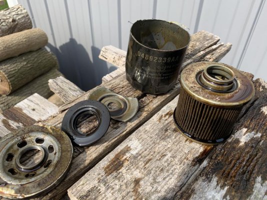

I found a pic of the mopar 339 filter cut open. Looks similar to your Fram:

That’s what I’ll be using on the next change (mopar 339). Your pressure is a lot better than mine ever was. Today I see 26-27 at hot idle and down to 40 at 75-80 mph. The more I drive it the lower the pressure gets . Ugh

Looking at your cut away of the RP filter, I can see where one of those plastic tabs might have broken off and impacted the oil flow through the filter. I don’t know but I’m ready to go as soon as the weather get a bit warmer. Twenty degrees is too cold for me to lay on the concrete at 74 years old. Ha
