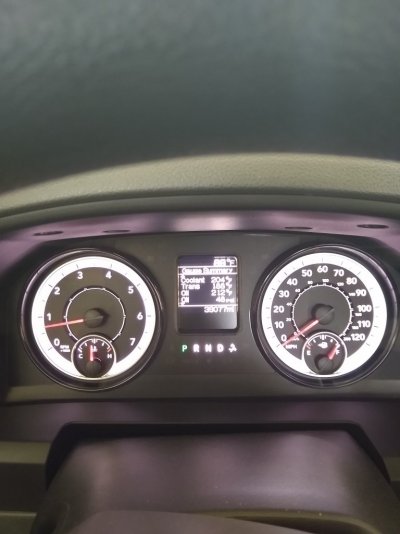

FWIW, here are a couple of pics of my HEMI's oil psi(s) at 70 mph(top) and hot Idle (bottom). These pics are from last September 2021when I had just changed the oil (end of August 2021) from Pennzoil Platinum 5w/30 to Red Line 5w/30 and is very consistent with these readings now.
I wish you continued good luck.
