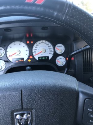

so somehow I’ve managed to make my automatic transmission gear selection square disappear to start. So it will not start and is stuck in 4 low as well which I’m sure won’t come out of because I cannot start it without a selector square any ideas what the f I’ve done or what I need to replace to have a transmission selection again?

Yep it’s just gone no box around my selection I’ve checked fuses all linkage nothing wrong just stuck in 4 low I’m sure because engine will not even crank because no selection indicator box any ideas what controls that box ?

Here’s some pics I’m stumped and sol any advice?

It moves just no box around anything appearing on any tranny selection truck no start

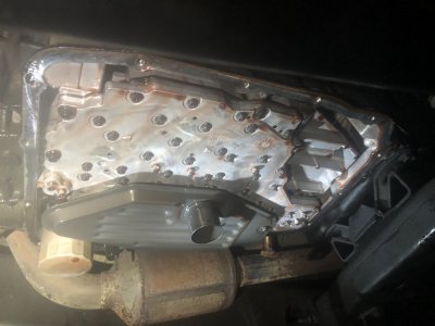

So I bought a range selector switch well 2 of them both kinds. I cannot for the life of me find where it goes on this year it is a 2004 5.7 Hemi. I even took the pan off dropped the guts still haven’t found this dam neutral safety switch or the range selector I’ve spent probably 8 hours looking and taking the transmission apart. Any ideas where it’s located on this particular year guys. I can’t even find a video on this particular year wow.

The highlighted square that normally surrounds the gear selection number is not there because the Transmission Control Module (TCM) does not recognize the manual gearshift selection.
This can be a number of things, but primarily:
* Check for an open IOD fuse in the Power Distribution Center (PDC)
* Check the transmission shift cable for binding
*Faulty Transmission Range Selector Switch (TRS). Based on your vehicle description you have the 545RFE transmission. In 545RFE transmissions the TRS is in the valve body.
