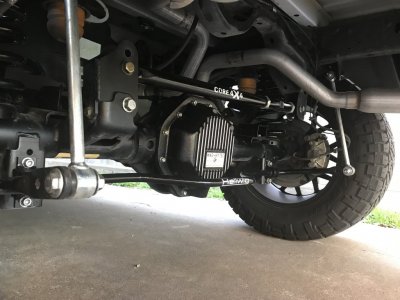

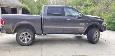

I have the BDS 6” without the preload spacer and Bilsteins @ 0.0 which makes it 5” front lift. The rear lift is 3” with Fox Shocks. I went with a 325/60R20, it’s bigger/wider than a 35 and smaller than a 37. I run that on a 20x10 -18mm Fuel wheel and I’m very happy with this setup. I take 1200 mile round trips 4 times a year and cruise at 85-90mph smoothly.
I used to have the lift cranked up to approx 8” with Bilsteins and ran 37’s but it wasn’t good for my trips so I went down to this current setup.

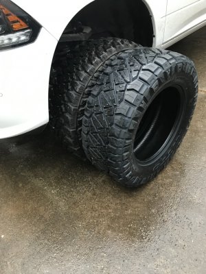

The last 2 pics show a comparison of the 325’s next to my 37’s.
I went with 325’s versus 35’s for a couple reasons. The 325’s are over 35” tall and over 13” wide and a load E tire. The 35’s are Load F and weighed more than my bigger size. Also, I wanted that wide tire look without going to a 12” wide wheel.

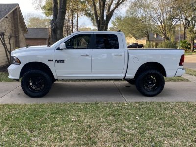

I did the 6" BDS lift and went with 35/12.5/20 tires on fuel 10x20 wheels. I like the look of the 35's on my truck but that's just my preference. You can also run 37's it all depends on what you like. One thing to note is I'm happy with my BDS lift. The quality is great but if you plan on installing it yourself like I did the instructions are horrible. I work on cars and trucks all the time and they were some of the worst directions I have ever used. Also the BDS lift it's expensive and from what I can tell the Zone lift is pretty much the same thing but much cheaper. There is a small 1/8" spacer that comes with the kit that you add to the front spring perch if you want the truck to be level. I didn't use it but instead set my Bilstein shocks up one notch and the truck pretty much sits level. Also I upgraded to the Fox rear shocks and they were way to soft. I could literally bounce the back of the truck up and down. I double checked the part number and it was correct but the valving was completely wrong for my truck. I took them off and sent them back. This is a pic of my truck with the 6" lift and 35's on 10x20 wheels.46f53fdd89a44d5e29160b90a6cd6e95.jpg

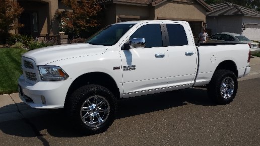

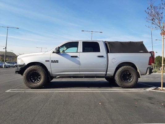

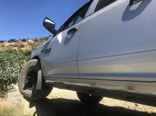

This is my truck set up with the 6" BDS lift and 5" rear spring option in the rear. Bilstein 5100's set at 2.1" up front with the preload spacer not installed. 35" tires on OEM wheels and 1.25" spacers. For me, the stance looks proportional.
On a side note, I think the truck would look much cleaner without the steps, but they work great to protect the panels from shopping carts and door dings...

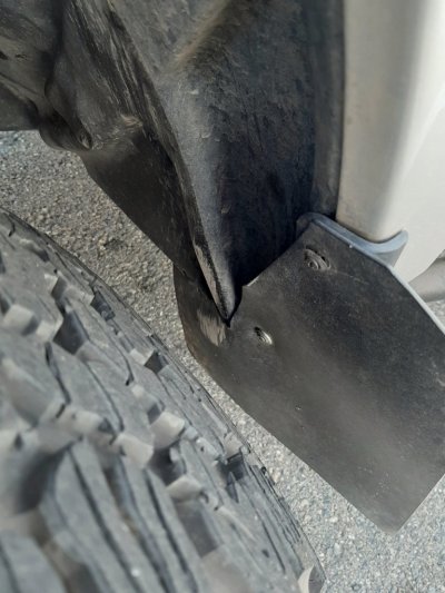

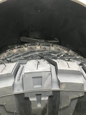

This is how bad my 37's are rubbing on my truck with just 2.5-2.75" in the front, lol
this is after 10k miles offroading so the size hasn't been an issue for me at all when it comes to having fun with the truck

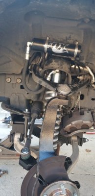

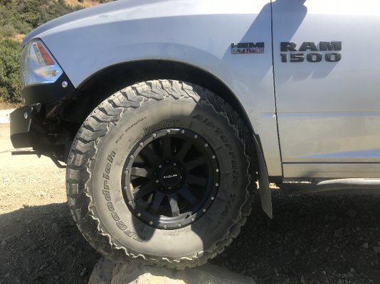

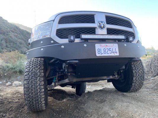

Zero rubbing in the front other than what you see in the pic. My wheel specs are 17x9 -12 offset.
Tires and UCA's or anything else in the steering have more than enough clearance
49222863693_a2b4bf0050_k.jpgUntitled by RAM RSM, on Flickr
48334091061_154d543834_k.jpgUntitled by RAM RSM, on Flickr

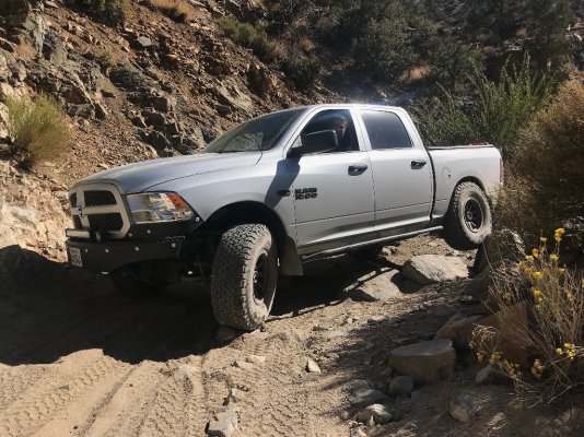

I have an aftermarket prerunner style bumper so that helps a lot. I doubt you'll be abe to run 37's with a small lift without that extra space from the bumper.
My front lift is between 2.5-2.75", rear is 1.5"

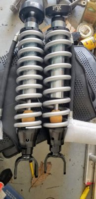

This is my front lift at about 2.75" with King coilovers
49330536192_56456cc4f8_k.jpg2020-01-04_03-39-10 by RAM RSM, on Flickr
And this is with Rancho QL struts and 1/2" top spacers.(I won't run a taller than 1/2 spacer myself) for 2.5" front lift. i used it for about 2 weeks or so while my King shocks were getting rebuilt and revalved last month. same cosmetic rub spots you see in the pics.
49602563241_a77bc61df0_k.jpg2020-02-29_07-14-03 by RAM RSM, on Flickr

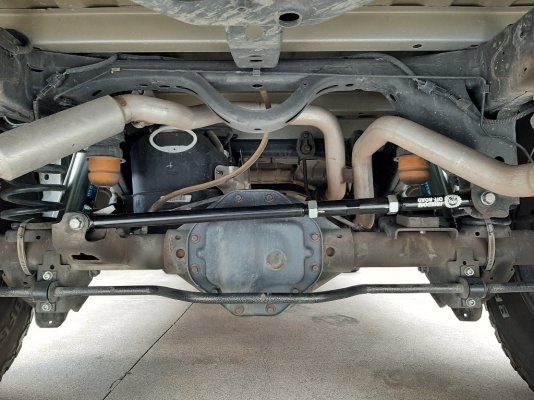

For the back i'm running 1" bumpstops from Metalcloack, you can see them here, fit like a damn glove
49664539047_be3b9c9bfc_k.jpg2020-03-15_06-17-09 by RAM RSM, on Flickr
I can tuck them in full in the back and nothing rubs, i can turn full lock either way while offraoding, the only thing rubbing is what you see in the pic, and is not even at full lock
48390014417_e2eac8159a_k.jpgUntitled by RAM RSM, on Flickr
48340709607_14b3b42a1f_k.jpgUntitled by RAM RSM, on Flickr
48888437151_609fd9a8d1_k.jpgUntitled by RAM RSM, on Flickr
48340561916_93492810cd_k.jpgUntitled by RAM RSM, on Flickr

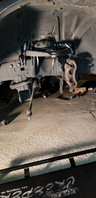

Super important with a small lift is the fact that i'm running higher than stock caster which will push your wheels forward and away from the back of the wells where everybody rubs with smaller 35's. Factory caster is about low 3*, 3.2-3.3*. You have to increase caster specially after lift, these 37x12.5x17 KO2's won't touch with this caster values for example. without that you'll have to do some metal cutting on the pinch wells. Not a big a deal though if it was needed.
46685766935_5100061348_k.jpg2019-04-13_01-21-06 by RAM RSM, on Flickr
For the back you'll have to remove the rear fender liners.
That's about for running 37's with a small lift, should be easier with a taller lift like 4" or 6" or higher.

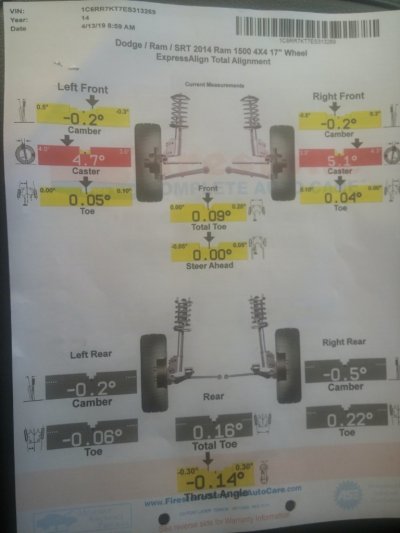

Super important with a small lift is the fact that i'm running higher than stock caster which will push your wheels forward and away from the back of the wells where everybody rubs with smaller 35's and .
Facttory caster is about low 3*, 3.2-3.3*. You have to increase caster specially after lift, these 37x12.5x17 KO2's won't touch with this caster for example. without that you'll have to do some metal cutting on the pinch wells. Not a big a deal though if it was needed.

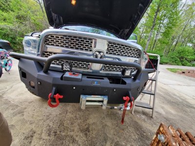

At some point I'm going to lift my ram and when I do I am going with the 6 in B D S it comes with everything and your money we'll be well spent

I like the wheels/tires tucked in a bit and on.my factory wheels, just my preference. That's why I took the Moto Metal Rims and tires off.
