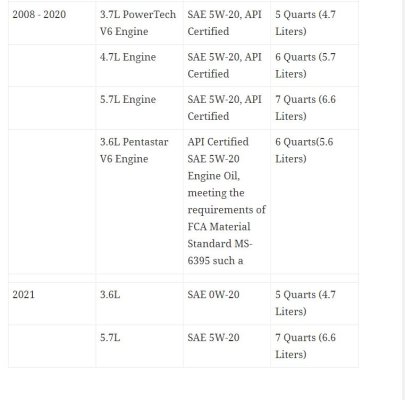

OP< maybe this help:

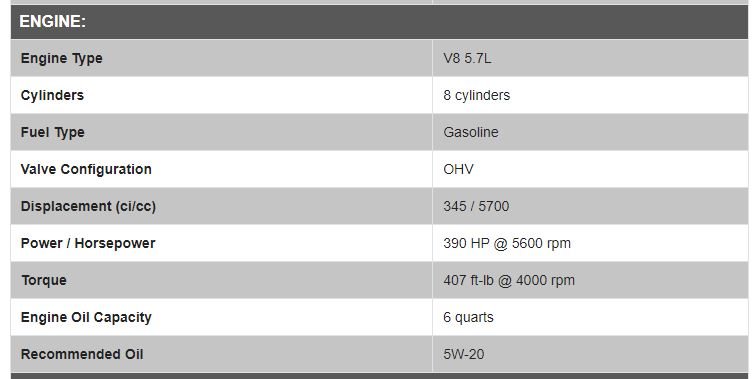

And here's info from another site: SO imho, WHO THE HECK KNOWS, lol.
Check out this URL, I would go off of this, but just IMHO. I think U got a 2013 dipstick but not for the 5.7L motor.

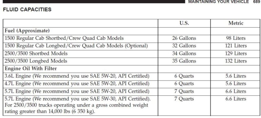

OP: This is right out of your manual for your 2013 RAM 1500: NOTE FLUID CAPACITIES REF 5.7L: So I really wonder if U got a 2013 dipstick but not for the 5.7.
BUT: Regardless what I or anyone else relates: Your TRUCK OP< AND DO WHAT U THINK WORKS FOR U.
