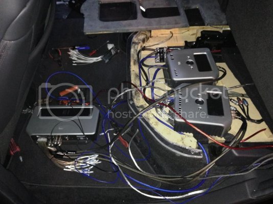

I got the MS-8 installed last night!!...
:wtf:LOL!!! ok let me explain...
1. I just wanted to make sure it worked and functioned properly since i bought it used.
2. I was racing against the sun bc i loaned my shop light to the guy im building the blowthrough for so... no sun = no bueno
In order to get it hooked up, there were a few things i had to change with my install...
1. Needed to run a new power and ground wire
2. Had to run wire from tweeters to where the ms-8 would be since my tweeters were previously running off the head unit.
3. Needed a remote wire, amps are signal sensitive so signal from RCAs used to turn them on. Now amps are required to be turned on by MS-8.
4. Had to run a wire for the MS-8 remote to the front. (pic below)
5. Rock out with my **** out
I also gave myself another project, Ima build a little fiberglass pod for the MS-8 remote/control screen. ill prob put it where its located i this pic below, but i want to make it removable without any noticable modifications.
Well, there was no rock out our **** out. It turned out to be a nightmare!! I managed to accomplish all of the above and get it fired up. Before I even calibrate I hear a loud whistle, like a bomb falling, then it goes away. I wasnt too concerned bc i expected some noise with the cluster fu@% of wires behind me. Well i get it calibrated and all the music is coming from the drivers side tweeter, and its staticy and sounds like crap. Sounds like a Lemming **** or some ****. Thought the tweeter was blown. I recalibrate...same thing. Its 10:30 Pm and im tired and have to work early so i say eff it. I go to bed thinking of a few things to try since everything was rushed to get in so im not too worried.
Fastforward to 3:45 am, I cant sleep over this crap. Back to the driveway... The tweeters are the only thing hooked to the ms-8 internal amp, and theyre the only thing i hear, so i unhook the harness for the ms-8 amp and Bam!...noise dissapears:happy107: but i can still hear music from the tweeter:wtf:? I must have it still connected to the head unit some how. Still dark so ill have to dig into it later. So i recalibrate, with one tweeter still working, so i covered it to see what happens and yay noise free music. Quiet bass free music....****!! wheres ma bass? I make a few adjustments to amp levels etc etc.... re calibrate....Bam music, with a little bass, all coming from the left side:favorites68:. Time for work... so i leave with my left side sounding pretty kinda good. Now I gotta get through the day with this $hit rattling my brain until i can get home and mess with it.

Well at lunch I went and tried something...
I pulled the sail panels and cut the wires to the tweeters and recalibrated. Also when it said look at driver side mirror I did..... Instead of passenger like I had been doing. Damn I'm dumb.
Hence the reason for only left side playing, the right was just over attenuated and I couldn't hear it. Damn I'm dumb
Result... Fkn INSANE center stage. Like I've never heard before in any vehicle. Like I feel like I can touch it. Right there dead center in the dash. But, very low volume. Which can be fixed pretty easily with some gain changes and a recal.
I determined left tweeter was seeing signal from dsp and head unit and right tweeter was not playing at all. Now instead of tapping oem wires I gotta get off my lazy ass and run them right.
Now I'm excited, I like where this is headed
