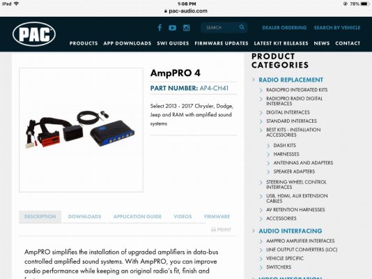

Trust me I definitely feel that “ frustration “ mood, but my wife says I’ll get past it. I’m about to spring for this unit so that I can start moving with the rest of my gear.2b512d2660f95cb4c3f94a45afd06df5.jpg

I have contacts at Pac, and they have not confirmed this yet. I have offered my truck as a test vehicle but no go. They are 10 minutes from me.

Technically speaking the Maestro product should be better than the PAC product. Historically that has been the case with the canbus interfacing. That being said I had the AP4 in my F150 and didn't have any real issues with it. You just have more options (even ignoring the built in DSP) with the Maestro and their engineering team is extremely responsive to getting out firmware updates.
My truck is kind of the guinea pig for all of your guys' which I'm fine with I guess it had to be someone. I talked to a tech today and he's confident that we can get all of the issues ironed out.
