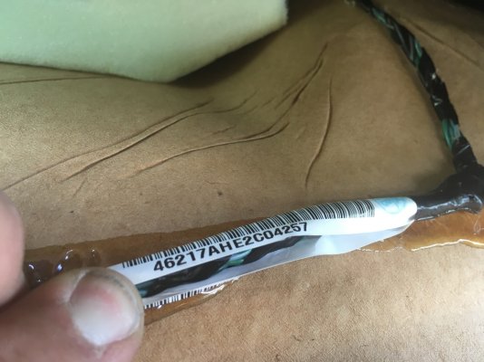

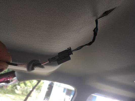

Well adding the overhead console to my 2017. The mics run through the driver A pillar. Harness info
That's above the liner. Told a few people I'd get pics and info.

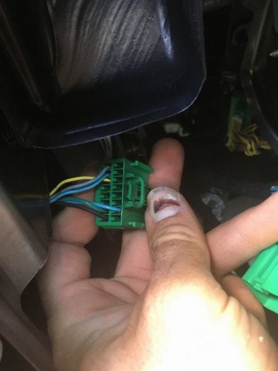

Output of harness behind driver AC vent feeding up.
In on harness

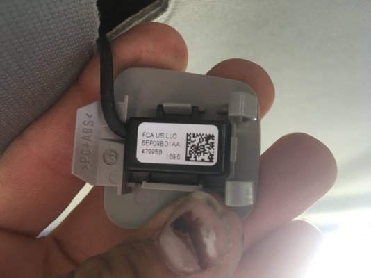

Mic part #

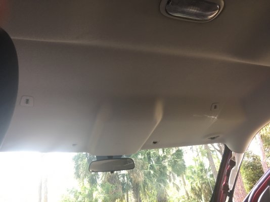

Location of mics. Yes 2 mics

oh ok yours are not in the mirrors

Colors feeding is gray striped with green and green striped with gray

Ok so on the harness by the AC vent red #1 seems to be constant 12v and yellow with the purple stripe in 11 is the switched for the dome light.

Just so everyone knows the pinout kit will be different for 2017. I had to modify the pinout kit that came with my overhead console to fit the factory harness in the dash.
