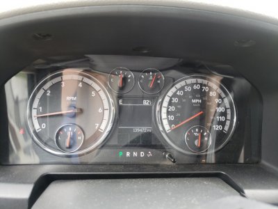

no the ac was broken when I got the truck in the middle of winter 2.5 years ago. found out it was the ac condenser in front of the radiator. Doesn't matter is ac is on or not it will start to over heat20180915_134418.jpg

yes ac is working. no heat. I took that picture as soon as I parked and shut the truck off
