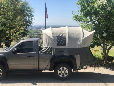

I do some overlanding. I have a GMC single cab with a 6 foot 4 bed and my 2019 Laramie with air suspension and off road package with the same length bed. I have a tent bed setup that I can switch to either pickup depending on how tough the trails are. The single cab is more manuverable than my crewcab Ram so it goes on the tougher trails. The Ram is great because it self levels the bed when I park. I looked at the rooftop tents and decided I did not want the extra expense and top foot print of them. I went with a Kodiak canvas truck tent. I made bed platform that will fit either bed with large slide out tray for storage. Your Rebel would be fine for overlanding. All I have are pictures of the Kodiak on the GMC but it fits the same on the Ram. I can set this tent up in about 15 minutes now.IMG_4380 (1).JPG IMG_4436 (1).JPG IMG_4375.JPG

I am a huge fan of the Kodiak tent. I had one that I used on my '01 and '14 trucks.
I just don't do the outdoors stuff anymore as it's all too far from where I live.
They are far better insulated than the traditional tent material types, I went through a couple good thunderstorms in the Jemez mountains without a drop on me.
