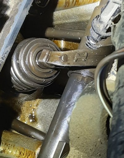

I suspected possibly valve spring but everything is tight. Only thing i noticed was that Rocker arm has play left/right and up/down on #5 because ?decompressed? Cyl? I suspect, you can see the play in pictures.
Thinking rocker arms possibly now, as the tick does sound like it is coming from somewhere around there. Can hear it from the top, and under the truck

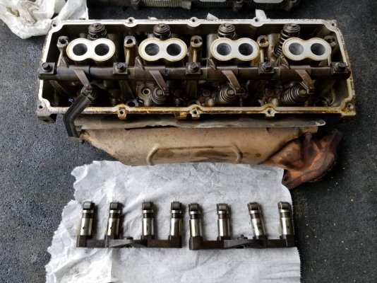

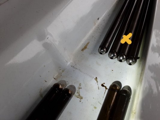

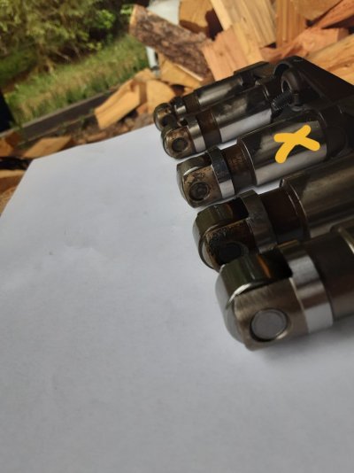

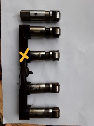

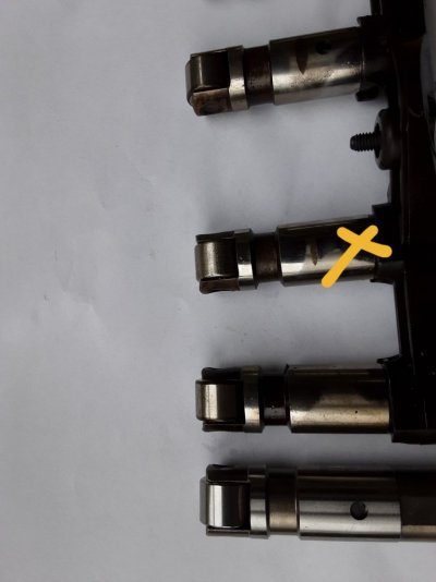

So today I had some time to pull the head off, there was a problem lifter on cyl 5. Roller won't move, doesn't look too horrible tho, I quit driving the truck once the lifter was stuck basically, as it was running bad.
Not sure, could I just replace the 4 lifters (I have parts on hand already)?
Don't really have the time (got visitors coming) and $$ right now for a full lifter/ cam/ top end rebuild... Found out I will also need to get a new waterpump, little wobbly in the bearing.
Will have to get some extra tools, how many kms/ miles could it last just to throw new lifters in? Pushrods look alright, not bent, have new ones as well.
I will borescope the camshaft tomorrow, see how it looks.

Borescope the cam make sure it looks ok at a minimum do the lifters on that whole side Also replace your exhaust bolts while the head is off.

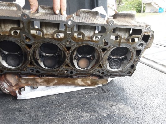

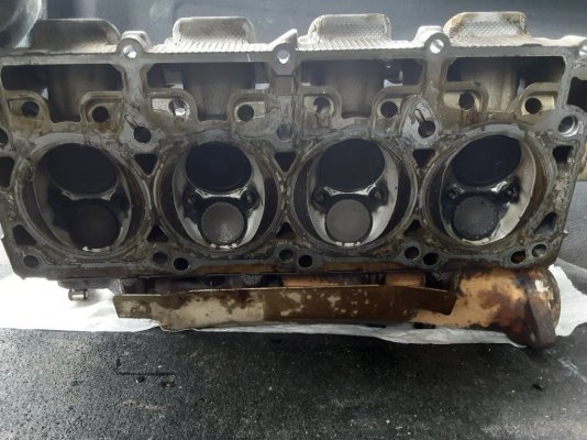

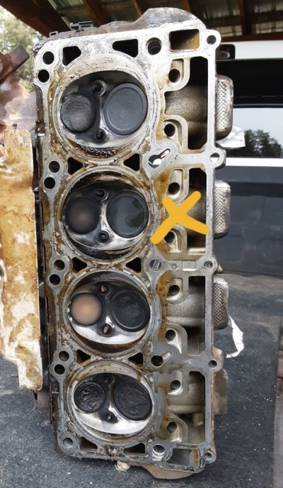

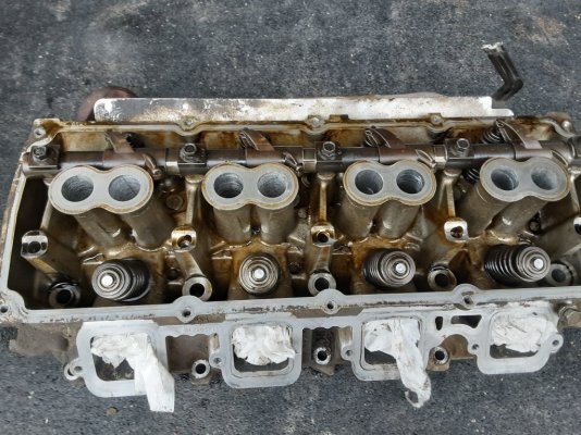

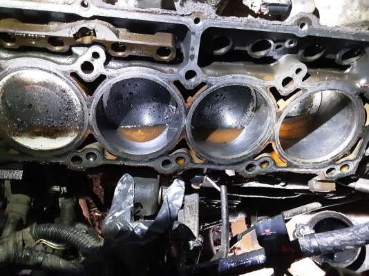

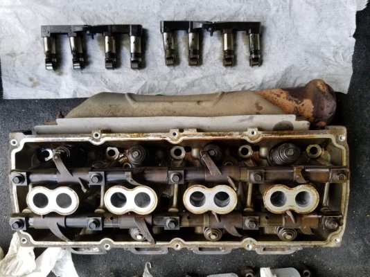

Thanks for your input, I ended up pulling the 2nd head just now. Ordered a bunch of parts aswell, they should be 1-2 weeks away:
-camshaft, water pump, all lifters, new pushrods, valve stem seals, headgaskets, new head bolts, intake manifold gaskets, timing cover gasket, oil pickup tube o-ring, a few exhaust valves,
shall I replace all intake/exhaust valves and springs too?
