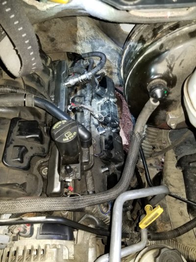

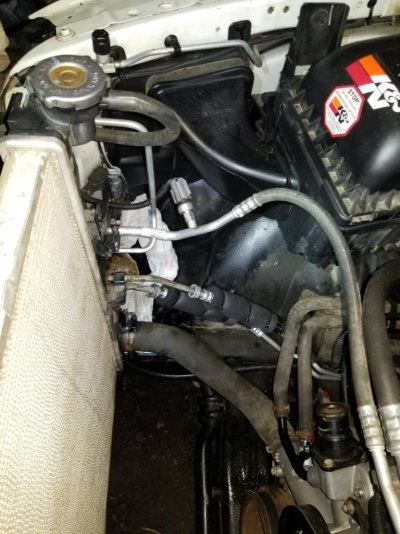

Pre sure the vacuum line for your brake booster i see the hose on the right.

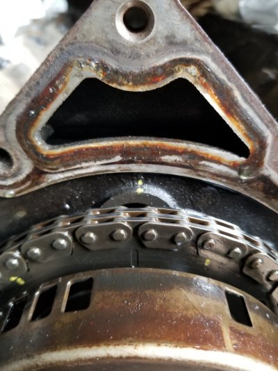

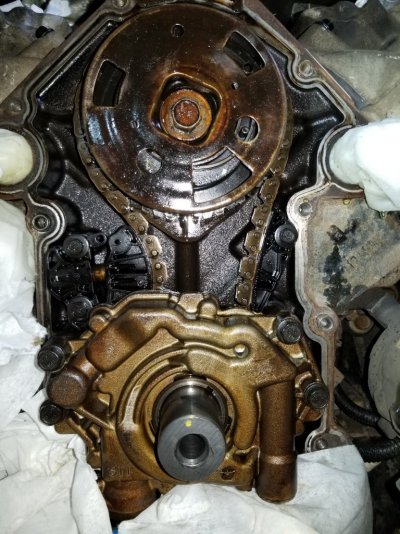

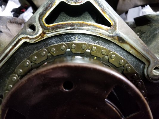

Tore it apart down to the timing chain again... 1.5hrs not too bad.
Now, looking at the bottom crank the key hole is at the 2 o clock position, but cam is way off center by the looks of it. Which tells me cyl 1 is at TDC, correct?
If i mark chain at tdc the way it is, remove chain from cam but leave tension on bottom, then center cam and line everything back up. Will that work?

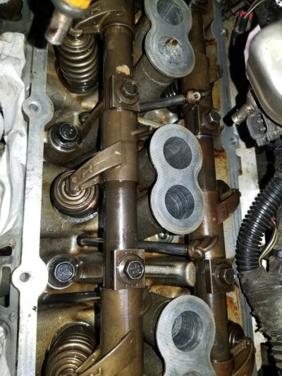

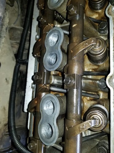

Pulled both valve covers and Hand cranked engine. All valves are moving fine and pushrods are tight and seated.

Arstar
Jul 9, 2022
Sparks, NV
Hang in there. Take a breath. Hate to say it, but it's like this guy said earlier...
Cam degrees are real easy to be off. Using a degree wheel is the only absolute sure way your cam is set right. You've made it this far- we're all rooting for ya!
You can I have done it few times that way but still easy to mess up the way your suppose to do it with the colored links 100% guarantees its set right do it whatever way you want tho lol.

Double and triple check push rods the most common cause of misfire after cam they can appear to be clicked in and one wont be all the way. I do this literally almost every time I rebuild a 5.7 never fails Also you may wanna check the VVT solenoid easy to break when pulling the cam.

Yea i hand cranked engine so many times today checking every rod, valve spring, movement, rocker arm lash and all seemed to check out alright.
Yes I had that sensor unplugged at initial start up, missed it.
Then had a brand new spare cam sensor kicking around I installed aswell, without noticable change.

Check compression just to rule that out to make sure you didn't bend any valves check all coil/injector connections not to hard to plug them in 1 cylinder off. I am not concerned with engine noise because you just put new lifters they are always noisy for a while.
