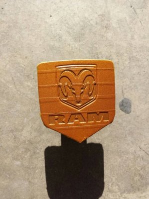

My paint is from carquest to match my truck in aerolsol can.... the item im painting is a steel hitch cover that has the ram head and the word RAM under it i did it once and screwed it up so the paint remover came out and i removed it all back to metal and taped it off again w green 3m tape. Seems better since down to bare metal once its done ill post pics

Sounds like it was a prep issue. With the lighter colors you need to have a lighter/similar base coat to get a proper color match, after that, several thin coats may be required to build up proper coverage. I was using sunburst orange as an accent for a while and that required 4 coats before it was finally a solid color. I've use the cheap white masking tape, the quality green frog tape, and standard blue or green painter's tape, all work, it's just the difference between how well each holds a solid line without bleeding and how easily they release.

Yeah i think so too.... it had black paint inside the letters and also the ram....i got it all off and started over we will see how that does after today i will check it again to see how well it dried.
