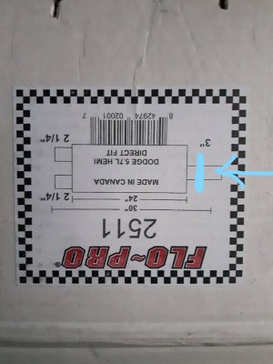

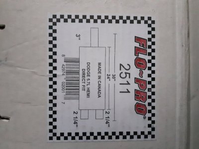

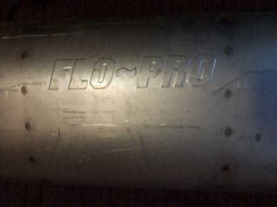

how does the flo-pro muffler sound?

It's in the shop getting ceramic coated right now I will have the muffler next week putting it on in about 10 days. I picked the pro flow because it's no drone and it's got a nice Rumble to it and it flows 15% more than a stock Muffler ,there's a youtube video clip in the 1st post.
After you install the new flo-pro please let us know how you like it. I might get one of theses if it truly has no drone.
