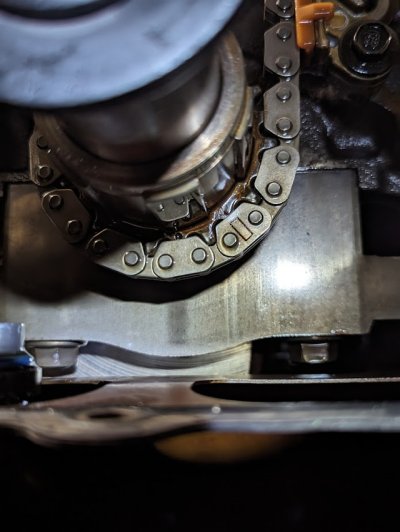

What's really raising red flags for me in my assumption is: that before I took the oil pump off, I was trying to get it TDC by looking at cylinder 1 and observing the timing chain marks, I wasn't having luck getting them to line up so I took a Sharpie and made my own mark when I was at TDC.
When I did remove the oil pump after that, I noticed my timing chain mark was off on the crank sprocket!

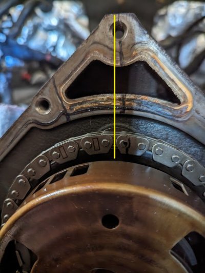

Here's an edited version of the Cam where I marked a line from the cam phaser timing mark, I'm aware my Sharpie mark is a little off:
The indicator on the cam phaser appears to be an engraved line versus a dot or paint
I haven't had a timing issue and it ran fine, clearly, it would have because it is technically in time, just the chain was put on wrong to where the marks don't line up.

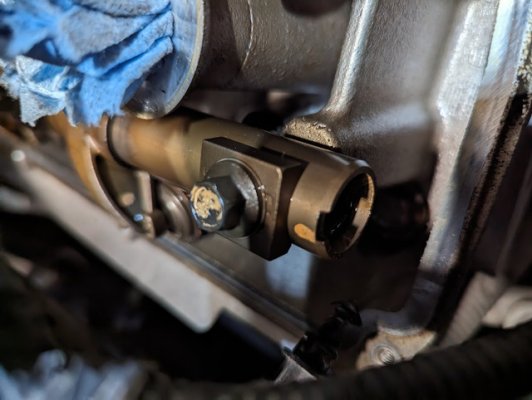

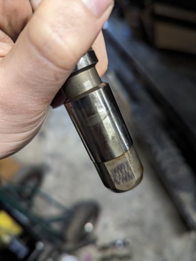

I started getting a lifter tick and caught it early which is why I am doing this. The lifter (non-mds in this case) that was making noise had some up-and-down play, no significant damage and I don't have any signs of metal contamination or real damage to the roller. Oil analysis said it had elevated levels of iron, but again, nothing was visible.
I have also observed uniform scoring on the lifters and cylinder walls and would like y'all's opinion on this to see if it is an area of concern:
It is uniformly the same for every cylinder and lifter.
Everything is Mopar OEM in it currently, didn't find any aftermarket engine parts. The heads looked super clean in the valvetrain like it was brand new.

Here are some more pics of markings I have found:
What are everyone's thoughts on this? Factory uh-oh, previously unrecorded rebuild, junkyard motor? I bought the truck with 119K miles a year ago, just shy of 133K miles now.
