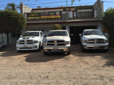

Thanks for your help
The ram is the best truck

Nice R/T Luis. Are Rams becoming more popular in Mexico with them being built there?

Damn, you have 5 of them? AWESOME!!!
They cheaper down there?
