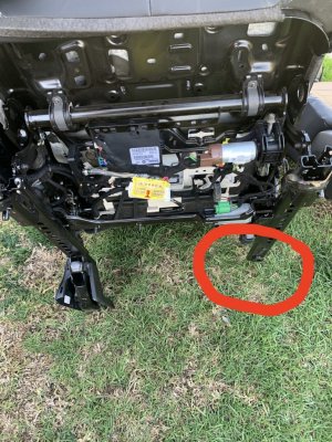

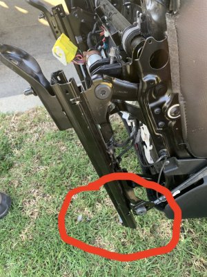

Heres a shot to compare..... (best one I have for now).
This is the Rebel passenger seat in question. Outlined is the area that is in question to be missing a part or not, but I'd like to confirm that be comparing another seat.

That was my understanding, however........ I've a speculation that a passenger seat from a Rebel I have come crossed may be missing a mount.
By comparing another pic would confirm this or not.
I work on these trucks daily, it’s all the same. The only seats that have a slightly different mount is if you have the base front seats with the middle seat. I don’t think it was even a option for a rebel to have the bench front seat. Pretty sure they all have the big centre console.

Ya that seat in the picture is missing the rear mount. It’s not supposed to look like that.
Tell ya what, if I see a rebel in the shop tomorrow I’ll try to get a picture for your piece of mind.
That would be great.
Next hurdle will be acquiring the missing mount piece. There's no visible damage, nor indication that anything was "cut" or "forced" off.

You are missing a seat mount
Each seat mount looks to have a different shape, i believe the mounts nearest the center floor hump are designed with an offset so they can bolt to the flat part of the floor
If you find the right part at a vehicle dismantling yard, you will likely need the bolt, if you don't already have one
Thanks brother.
I wasn't sure if for some reason the "Rebel" seats had different mounts, which would be odd, but nonetheless. The videos you shared certainly show that mine is missing the leg mount. Thought they would have been welded, but guess not.
