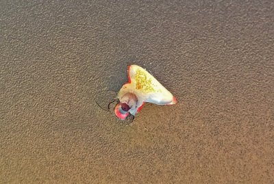

Ah... good to see this as I'm getting ready to fix mine. Some idiot shot a bb into my side pillar. Went in the metal 1/4". just a few inches more would have gotten the window right at head level. I didn't know a bb gun had that much punch! See pics.RamRockChip2.jpg RamRockChip.jpg
