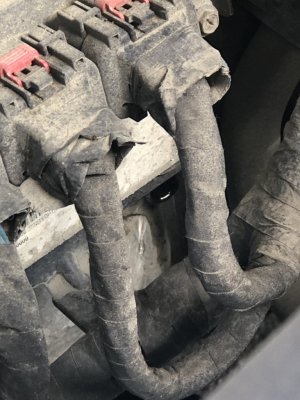

Please help. I’m new and this may be the wrong place
Roman_78
Sep 1, 2020
29
Evansville
this is just cranking out fluid. My buddy says it’s the ac. But I’m not sure. It is just spitting tons of fluid. Am I missing a hose? Sorry I’m just a 21 year old guy. I just got this truck. It’s mine not my parents. So any help would be appreciated

Can you give some more info? Engine size and maybe a wider shot for reference.

Sorry 5.7 hemi. I cannot actually get a better shot of it because of where it is. It’s located driver side where the engine bay meets the cab. It comes out from the cab.

Can you take a pic further away? I want to see where those connectors are located, I see the small tube at the bottom you are talking about but have no reference point.
The Ac drain line is located on the passenger side of the truck I believe.

That's the computer on the passenger side firewall. Check the two heater hoses that run along the valve cover and up to the firewall, they're right next to that area.
If it was your AC it would be an oily mess, that looks more like dried coolant stains.

You may have a leaking heater hose. What kind of 'fluid' is it spitting out?
I'm guessing coolant, if it was freon it would blow out in 30 seconds and be empty (and your AC would blow hot)

Did it rain recently? your A/C evaporator drain is on the Passenger side kick panel as well the heater hoses, if thats coming out of the firewall, its got to be water from the cab, does it have any color to it?

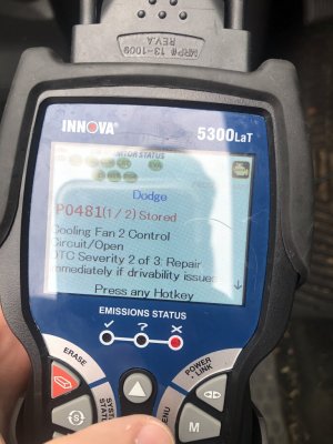

Ok no color. It did just rain. Let me snap some photos. Also my check engine light came on and this is what the computer said it was any ideas?

That little nipple below the computer is your A/C evaporator condensation drain. When the air conditioner evaporator gets cold it sweats just like a cold can in your lawn chair and that water has to drip somewhere. If you were in Arizona you'd barely see anything but you're in the Midwest so you know how humidity works.
So unless it's shooting out of there like a garden hose somehow I wouldn't worry about the drip at all it's normal that's what that hole is for.
As for the cooling fan that's a separate issue, and yeah you want to address anything to do with cooling ASAP because an overheated engine means a dead truck and I don't know about you but when I was 21 a new engine wasn't in the cards financially for me. Heck I'm more than twice that and it's not something I'd be eager to buy.

Good luck man I hope that cooling fan trouble code ends up easy for you to fix.
