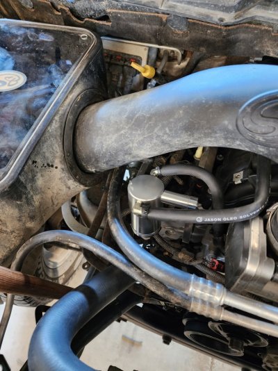

Lets see a pic of how you ran the catch can hoses.It's pretty tough to screw up a catch can install,but it has been done. If the can is plumbed in properly and doesn't have any vacumn leaks it shouldn't affect how the engine runs,or cause a throttle body code

yea i think it might be a little crimped
If the hose is collasping when it's hot at the bend under vacumn it could cause an issue. The other hose is also on the long side,you could turn the fitting down slightly,so it points down a bit more and shorten the other hose to.Are the hoses your using a good quality reinforced hose. Also listen for any vacumn leaks at the can or fittings.

would a vacuum leak cause the code, cause i don't know if i closed the valve on the bottom of the catch can.

It might,but you should of had a massive vacumn leak that would be easy to hear,and the idle would of been high as hell.
