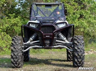

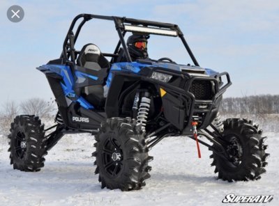

I’ve only researched these in the side by side world but the benefits to this type of lift is you can get higher ground clearance while keeping your driveline angles as originally designed, also, sometimes they offer some different gearing that helps with larger tires, rock crawling etc. the major downside is it’s expensive AF. But I guess when you want the best you have to pay up. If you look up Polaris Rzr with portal gear lift, you’ll see some swamp buggy’s that are running like a 6-10” suspension lift on top of a 4-8” portal gear lift as well with 35”+ ag tires to just walk over the mud bogs.
For reference;
This one is a 6” lift via portal gear, notice the driveline angles. Price for these are 3,999.95$
This one is a 10” lift via suspension lift brackets, Notice the driveline angles. Price for this is 1,999.95$

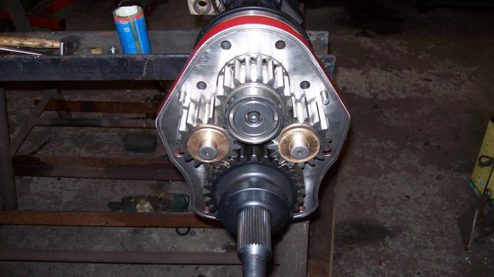

Most of the ones available are not really meant for a daily driven vehicle. They are expensive and put ALOT of stress on the steering and suspension due to the leverage they create.
Biggest bonus aside for the massive amount of ground clearance is:
1) gear reduction at the hub, most likely 2.1. This means you probably don’t have to regear or In some cases go to a higher (numerically lower) gear set.
2)strength.......since there is a reduction at the hub, the “upstream” drivetrain has less of a workload if you will.

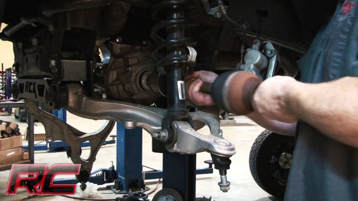

Portal axles give you gear reduction and ground clearance.
When you lift a truck with solid axles (like a RAM 2500) you raise the body and chassis and some of the drive train (i.e. the transmission and transfer case), but you don't do anything to raise the lowest point on your vehicle - the differential housing in the axle (a.k.a. the pumpkin). You still drag the differential over rocks, your axle tubes get hung up, etc.
When you lift a truck with independent front suspension (like a RAM 1500) or fully independent suspension (like a Hummer H1) you actually do raise the differential of the independent axle(s), but then you create problems with your drive line angles - as photoed above with the RZR's. Trucks are not very tolerant to out of OEM spec drive line angles and to compensate for this many independent axle lift kits will actually use drop brackets to lower the differential section down to maintain drive line angle; so now you are back to not gaining any meaningful ground clearance for the lowest part of the vehicle - the differential.
Here is a great shot of an IFS differential drop bracket - see the metal plate with "RCX" cut out? That's part of the bracketry that lowers the front differential to try and maintain the factory drive line angles:
Now - portal axles replace your factory axle hubs with a "portal box" which has gears inside of it. The top one is where your factory axle goes and the lower gear is where your hub goes (where your tire bolts on) - see the photo below.
So by putting this "lift" on the outside of the axles you actually lift the entire axle, differential and all, and you maintain the factory drive line angles. Portal boxes also allow you to have different reduction ratios so you can get SUPER deep crawl ratios (like a Unimog) and, as was said earlier in the thread, actually reduce stress on upstream drive line component (e.g. axles, transfer case, etc.).
So - do you need portal axles? Based on how you described your use case, absolutely not. You're looking at 10's of thousands for a kit (if they even exist for RAM) or you're going DIY. You need to deal with ABS, traction control, all the other computer crap that the RAM has on it. It's not worth it IMO. You'd be better off buying a more capable off road rig that has portals from the factory, or something like a Jeep that has a massive aftermarket available (which have bolt on portal options).

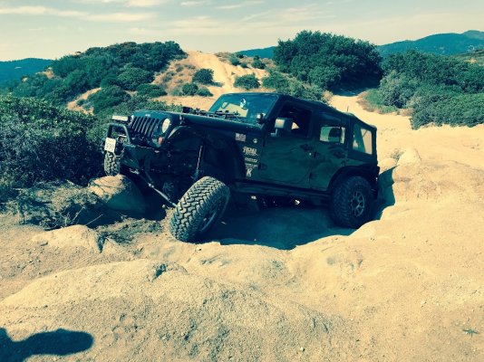

I have Graham and Shaun in my youtube favorites, those dudes can drive offroad and their rigs are in excellent shape for that too :)
You don't need portals to do sand dunes. Just enough tire with tall sidewalls to lift your belly off the ground at 12-15psi or so and a small lift, Cool thing in the dunes you don't have rocks that can damage the plastic fuel tank we have. The biggest gripe i have with my RAM 1500 is the lack of aftermarket armor and aftermaket support as a whole as an offroad enthusiat myself.
The Mopar skids are a joke thought at least you can say you're minimally protected. I would be doing a lot more aggresive trails if we had heavy duty aftermarket skids that will protect all the belly and gas tank so for me i'm enjoying fast offroad dirt, moderate mountain trails with some rocks, desert wash trails and sand dunes.
I have steel bumpers so hitting rocks with them is not a problem just spray paint the scratches when needed and that's it. This trucks are too big for rock crawling anyways and the longer the wheelbase the worst in that regards. I came from a Jeep Wrangler Sport Unlnimited modded for moderate rock crawling with 4.56's, an Eaton rear locker and front Detroit Trutrac. You have no idea how much i'm missing this type of action.
36820635312_4b05e5777e_k.jpgUntitled by RAM RSM, on Flickr
34258026210_043f549786_k.jpg20170513_120625 by RAM RSM, on Flickr
33798327684_475314af2d_k.jpg20170513_121549 by RAM RSM, on Flickr

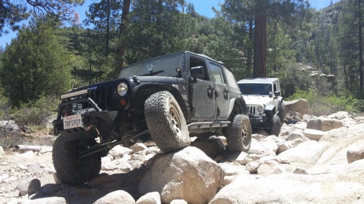

If i didn't have the fun my King suspension can provide in the dirt i'll have dumped this truck back in the dealer long time ago, that and i can have the cargo/interior space i need to carry my whole family of 5 plus a little doggy in comfort when we go out to the outdoors.
I may have another Jeep Wrangler in the future, i bought a used 01 WJ as i thought i wanted that to be my offroad project but i'm not feeling the platform at all and i haven't been inclined to mod like i should, i like JKU's, and now JLU's and JT's though the last is too damn long.
41615434605_3caff9423f_k.jpg2018-06-02_09-42-58 by RAM RSM, on Flickr
Have fun.
