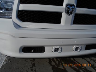

The dealer used to have a retro-fit foglight kit that fit in the rectangular bumper cut-outs,but when i went looking for it for my 13 several years back,it'd been discontnued.That's if the bumper you're referring to is similiar to this bumper. I ended up cutting a set of flush mount Ridgid driving lights into the bumper,and just used a dash switch and relay to run them

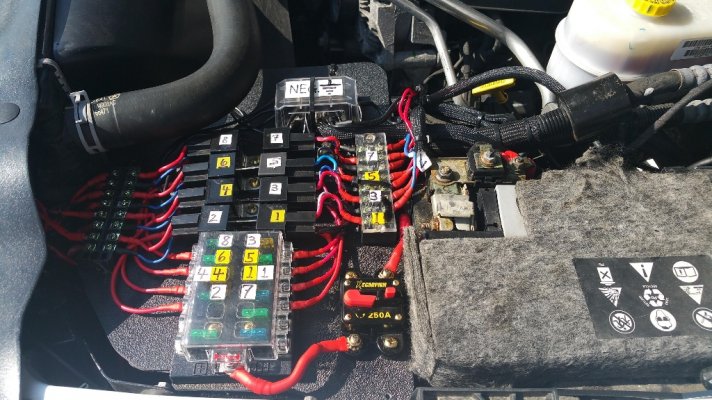

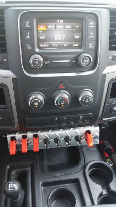

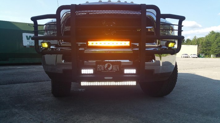

Make your own with LED's. Did it on my 2500 and they work great. Every pair and every bar has it's own switch. Made a relay/power distribution board up so the only connection to the truck is battery + and ground -. Dealer can't blame any electrical problems on me splicing anything. And it was fun.7e7f6b4f0ee06a14894341fc2cde6d20.jpg9bebd8f0da3a3315ba5b8d1a6444e810.jpg0d7de2f8bc0253e111ede783195c2179.jpg
