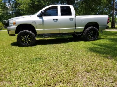

No body lift. 4 inch zone lift kit, with rancho my ride quick lift struts for a total of 6in front 4 in rear. 20 inch moto metal rims 10in wide with -24 offset. 35x12.50 federal couragia Mt tires. I have a few more pics if you want just let me know.

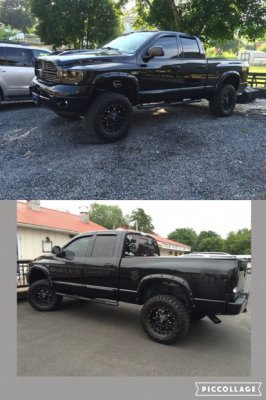

6" rcx with 35's. Need to bump my bilsteins up to .7" setting from zero cause I still have a little rake yet.

Blackbeauty how much was your lift? Where'd you get it? Are you 4x4?
I'm not having an easy time finding a 6" lift for around 1000. Can't swallow spending 2k+ on a fabtech or skyjacker when the install at my local truck place is 1000

Ordered it straight from rough country. I think it was $1100. Mines 4x4 but 06 and up have a different front suspension than yours. That's why the sizes are different from mine to yours.

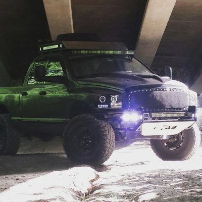

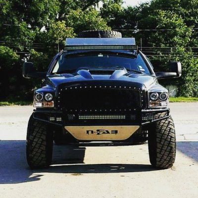

I'm running a 7" 2wd lift on my truck. I thought about a body lift on top of it but I don't want to see the spacer in the front because the bumper wouldn't hide it.

Put a 52" curved bar there it's just another spot for a light

This may be stupid question but what about brake hoses with that lift? I've only lifted one truck (not dodge) and with a 3" or so front lift I had to order longer hoses.
The newer style with the big headlights require lifted hoses and the first style doesn't until about 4in lift
