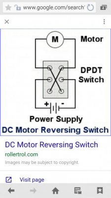

Ok this is a picture of the switches I used and a wiring diagram to wire them for reverse polarity. Remeber to get the 6 pole momentary switch. You can fold the mirrors in or out as much as you want individually. I ran the yellow and blue wire from the passenger side mirror to the driver's side door as well as a positive and negative wire. I ran the positive from my battery to a fuse box I installed under my drivers seat. I use it to run my seats,mirrors and illuminated sunvisors. I installed the two switches side by side hooked up to each mirror separately. As I stated the hardest part is running the wiring into the drivers door through the factory harness.

Great info. I might just wire both mirrors to 1 swicth
