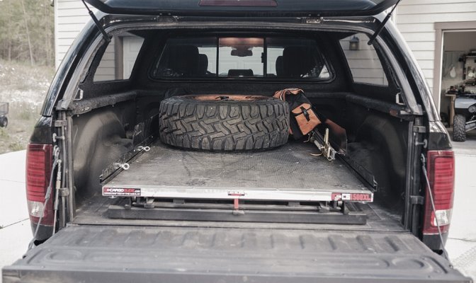

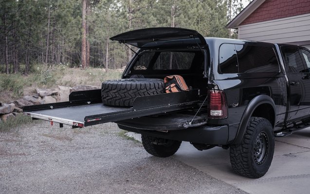

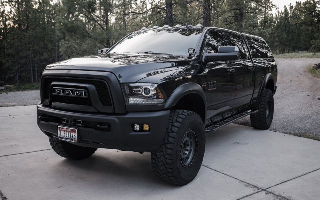

I'm more of a lurker, but I wanted to add a few pics to the gallery in case anyone wanted to see a certain look or piece of equipment.
I am the second owner of the truck, which is a 2018 with power seats, luxury package, tow mirrors, 8.4" Uconnect, park sensors and remote start. If you are on Expedition Portal, then you have seen the original build thread.
When I bought the truck, the following upgrades had already been accomplished - pretty much all of them I would have done had I started with a stock Power Wagon:
-Thuren 1.5" front springs
-Method Racing Vex 18x9" wheels
-Toyo Open Country R/T 37x13.5x18" tires (with full spare)
-Dethloff skid plate
-Factor 55 Flatlink
-Baja Design lights in the fog pockets and ditch mounts
-Snugtop Super Sport topper
-plus a handful of other minor mods
I continued the progression with the following additions:
-White Knuckle Offroad sliders
-CargoGlide 1500XL bed slide
-Wilco bed mount tire carrier (mounted to the CargoGlide)
-Bushwacker Extend-a-fender fender flares
-AEV Procal (fixed speedo mismatch and TPMS with the bigger tires)
-Lock'er Down console safe
-Bayou Goat Mounts triple mount
-MobArmor Tabnetic ipad mount
-Assorted items for recovery
Future:
-stereo upgrade (6 speaker set up is horrible and a front camera would be nice)
-more lighting front and rear
-Rhino Rack on top of Snugtop
The pics:

That triple mount is sweet, might have to look into that on especially since I already have one mob armor mount and was looking to add a second for a tablet for GPS maps

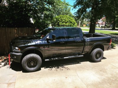

Nice rig but holy ****, $985 a month! That's almost my mortgage payment. Also just a heads up these trucks do not like a heavy negative offset wheel. You will probably have to do some serious trimming of the pinch weld and plastic at the rear of the front fender Wells. Especially if you plan on running 37s
The rough country 4.5” lift kit for the power wagon is made specifically for this truck and 37” tires

The rough country lift is nowhere near capable enough for people who use their power wagons as they are intended, the shocks will blow out and you’ll still be dragging the same components on the ground as if you had done a Thuren lift from the start.

Didn't realize you were lifting it. But as IRSmart said you might really want to look into using thuren stuff. They are pretty much the standard for PW suspension components. You could just do their 1.5" leveling springs and a +18 to +27 offset wheel and have 37's with no rub. Wheel the crap outta it and be confident crap won't break. Not trying to tell ya what to do, just giving you other options. Especially if you plan on doing any wheeling in the beast.
