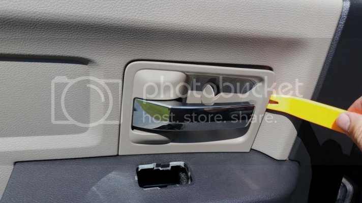

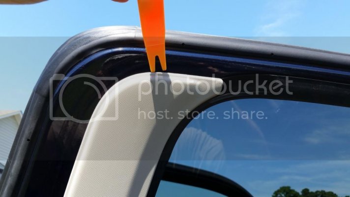

Removing the rear doors is just like removing the fronts...
Pop off the vertical trim panel
Pop up the power window switch and release the harness
Remove the screw behind the door handle and the little plate around the door handle
all the little panel screws around the perimeter
and the lift the door panel up and out.

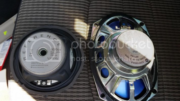

As with the other Infinity Reference components there is a significant difference in the magnet size and build of these speakers and the 'premium alpine' speakers.
They look really good in the doors and sound amazing. Much better mid-bass response than the 6x9s. Due to the factory amp and crossover settings only the 6 1/2 woofer was installed in the front door.
These speakers made the impact I was looking for when I first decided to replace the factory 6x9s. I really wish I bought them first... but then I probably would not have upgraded the the rear doors... so I guess it all worked out in the end.
