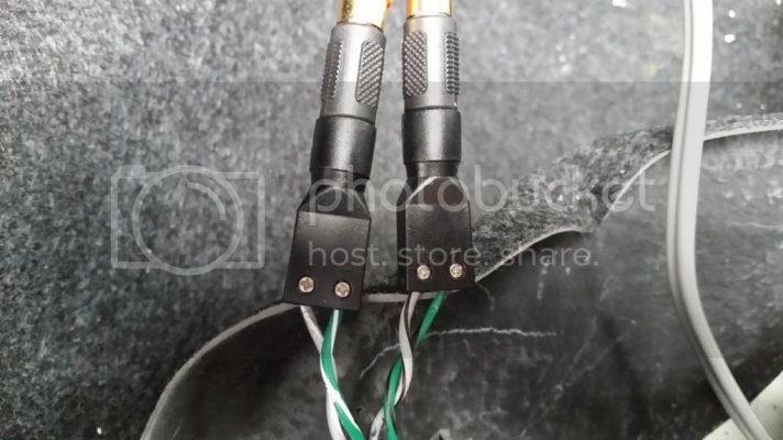

Question. I removed the factory alpine sub, tapped my LOC to the speaker wire going to the old sub... Do you know which colors are positive / negative?
Or what speakers did you use to tap for the LOC?

The big question is how do the amp and subs work off this signal? Are the low notes hit as well?!
I’m using the sub signal via net audio harness.
The amp I'm using is able to receive both 'low level' rca and 'high level' line inputs. To leverage the factory sub wiring I had to set the switch to HL1.
