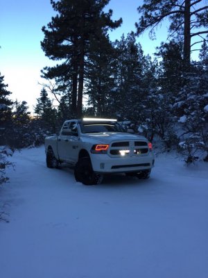

Pre runner ? Like Cali lean ? Do a 7" MaxTrac spindle lift up front with some 2" wheel spacers only up front and you'll have your pre runner look.

That's mine but I didn't go for a pre runner look. All my friends have pre runners. I just wanted a nice lifted truck
