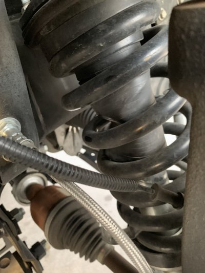

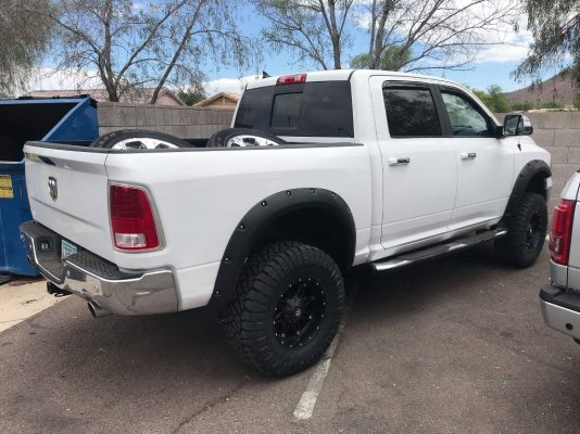

Just was hoping to share my experience with the pro comp pro runner shocks. From day 1, I was running the pro runner shocks in the rear after I got my truck back from the lift shop getting a 6” pro comp lift put on. I did notice it sat slightly lower in the front as only factory shocks on spacers were used.

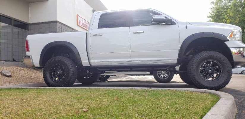

After a couple months I went ahead and ordered the matching set for the front in hopes of leveling the truck out. Which it did thankfully. The front pro runner shocks have a coupling that you can have it flipped either or. I don’t recall the sizings or measurements but one side makes the shock sit a little taller, the other side a little shorter. I went with the taller option and to my liking, it made the truck level. After awhile I even noticed the front of the truck sat up a little taller too than in the rear.
I noticed improved handling in turns and less of a roll which was nice. I took the truck off-roading on a trail and did pretty well for a desert side by side trail.
My only complaint though comes just recently after having the fronts on for about 3 months and way under 4000 miles. I was in the middle of an out of state move when I noticed the truck had a ton of creaking in the front especially on turns. Well after a 15 hour drive I come to learn both fronts had blew out and I was riding on springs. One shock was completely empty no gas (nitrogen charged) or fluid of any type. The other one was about “half way empty” according to the shop I was getting it fixed at. I was even told they appeared to have a very slight bend in the shaft. To my dismay, I found out online that these front shocks have failed others too at similar mileages. Unfortunately I was not able to get measurements of anything right after install, but a day before I got the shocks fixed, the front was at 11.5” with a 35” tire from fender to tire and the rear was 10.5”. Obviously since then I’ve gotten a few mods like aftermarket bumpers which do weigh more and may have affected how the leveling was.
I contacted 4 wheel parts where I had ordered these pro comp pro runner shocks (and who owns Procomp) and they offered me a full refund so no problems there.
As of right now the rears seem to be doing just fine. I’ve has multiple weighted loads in the back with no troubles at all.
Once again I am just wanting to share my experience in case anyone wanted to know more.
