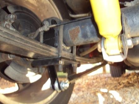

Plate I believe goes between the leaf pack and the axle, since the perch will be on the other side, and the new ubolts attach the caltracs to the newly flipped axle. Ill eventually get a mount to weld to the axle for the flip kit, but I didn't get one yet.
CalTracs are dead simple to mount, you don't need plates or new U bolts.

If you dont need the Ubolts... then what holds them onto the leaf pack, and onto the axle? The new U bolts! They're a ton stronger. And the Plate goes between the axle and the leaf pack, there's a small little circular notch that sticks up on a non-flipped truck. That notche usually seats into the spring pack, but since it'll be flipped, it will get in the way of the axle and the leaf pack sitting flush. So the plate acts as a spacer, and seats around that notch... That's why theres a hole in the middle of the plates.

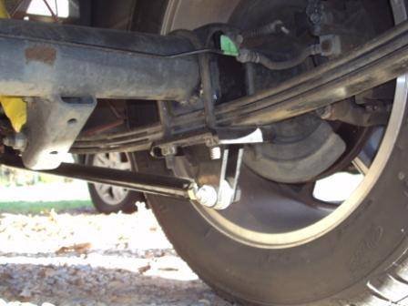

Trip, Those U bolts and plates look like they came with the CalTracs and are not part of the flip kit. The flip kit will have the new spring perch that also braces the bottom of the original perch which in turn positions the axle at the proper pinion angle. The problem is the original perches are designed to be clamped to the spring and now have rotating force being applied to the opposite side. This doesn't make for the strongest setup and it has been reported that some axles have rotated under acceleration. I welded mine to prevent this from happening. All this is difficult to explain but look at my picture and you should see what I am trying to discribe. I used the original OEM "U" bolts and the CalTrac brace replaces the bottom spring plate. No O/L of course. Hope this helps..
The ubolts and steel plates are part of the caltracs. I said I hadn't received the Flip kit parts yet. Anyways, I'm not using the stock U-bolts, Im going to upgrade to these bolts they sent anyways. The problem I think I might have... is if you compare my picture VS yours... They send me different parts. The back part that hooks under the spring pack that connects to the rod... Mine looks completely different then yours. I think they send me the parts for a non flipped axle. And also, they send squared U bolts, not actual U-shaped bolts.

I think you are right in that you have a non-flipped version.

Good luck bud and deff weld the rear like Redtruck said. There tons of threads were even 4.7s twist the axle the first time they romp on it, not a good feeling to send the drive shaft flying and beating the hell out of your truck.

Here's the finished product:
Right side Air Bag
Left Side Bag
Fill Point
Rounted AIr lines
HellWig Sway Bar
Flip Kit (Notice Axle is now on top of the spring pack)
Spindle (Notice the part I notched on the lower half of the spindle, so the lower control arm wouldn't rub. It wouldn't fit without cutting that section out)
