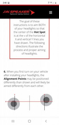

You say your cut off is on trunk lid when you pull up behind, it should be, your almost at ground zero..... Where is your cutoff on the cars at 25 ft out?
You headlights dead center should be the same height off the ground to center @ 0 and 25'. Like mounting a scope on a rifle with no gravity
