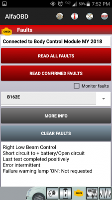

I connected to the truck with AlfaOBD and checked for faults. Now I did lock and unlock my truck with the headlights not installed, so it could have something to do with these, but not sure.
I cleared the faults and tried again. Still no high beam shutters as far as I can tell.

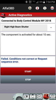

So I ran the tests on Alfa and got this
The tests for low beams, high beams, and turn signals passed. Even though I've never seen it mentioned, do I need to tell Alfa that I have projector headlights?
Anybody have any insight on this? I need to figure out if this is a problem with the headlights or the conversion harnesses or whatever else.

I'll run the same tests on mine tomorrow to see if I get the same results. I know for sure that I have not messed with any of the settings for anything dealing with lights (other than license plate lamps). That includes changing over to projector settings in Alfa.
I know some of these types of tests have failed in the past when using them but the developer has fixed most of them to my knowledge. This doesn't mean that with the releases that something didn't break..
Also, when I flip my high beams on I can hear from in the cab the shutter movement.

I was wondering whether all the tests were valid or not. But my high beam shutters are definitely not working. I need to figure out which pin on the headlight is supposed to get power in order for the shutters to function. I never anticipated this problem....*sigh*

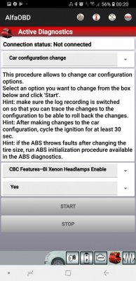

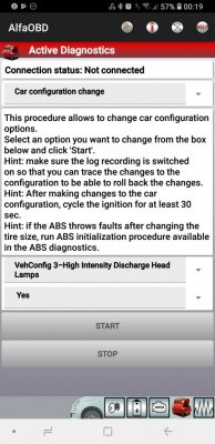

Turn on this for proper high beam function.
And just incase
