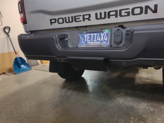

Supreme Suspension makes a trailer hitch skid similar to the one made by retired. It works and won't set off the rear sensors. Under Body Armor also makes one but it will set off the rear sensors because it is too big.

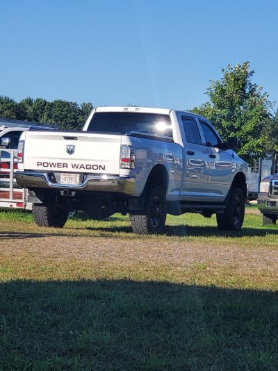

This is on my 16 if you zoom in you can see the black sensors on the rear bumper.

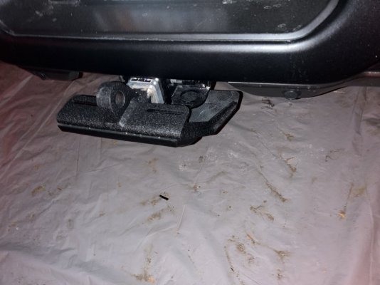

Here is a picture of the Supreme sSuspensions hitch skid. It came with a recovery point for a D ring. The tow point is drilled for a 7/8th inch pin which can be hard to find so if you are looking at this order it with the 7/8 pinned Dring included.IMG_7519.JPG
I ordered one. They have a 12% off code right now on their website. With no offer code, they are actually cheaper through their ebay store than their website.

Here is a picture of the Supreme sSuspensions hitch skid. It came with a recovery point for a D ring. The tow point is drilled for a 7/8th inch pin which can be hard to find so if you are looking at this order it with the 7/8 pinned Dring included.View attachment 509424
Is that recovery point just welded to the top? That looks super sketch, I've seen welded recovery points just rip right off.
What sleeve are you using to adapt the 2.5" receiver down to 2"

My pickup came with a sleeve from the factory that is aluminum. It was in the storage bin behind the drivers seat.
Hmm, I don't think I have one. I picked up one at Lowes to try, but I'm returning the Supreme Suspension hitch armor. It's pretty loose, measures 1.958" with my calipers and it noticeably wobbly in the sleeve. To eliminate the issue being the sleeve I tried it in my son's 2" receiver and it was wobbly in there as well. I'm afraid it's going to be a source of rattles plus I didn't care for the way the recovery point is welded on once I got it in my hands. I'll have to try something else.

I have never noticed a rattle with mine. I looked at some of the anti rattle trailer hitch devises but none fit because the hitch is mounted so close to the bumper. For a recover point you can pull it out use a style you like. I have tried others but they are bigger and trigger the back up sensors when backing up.
