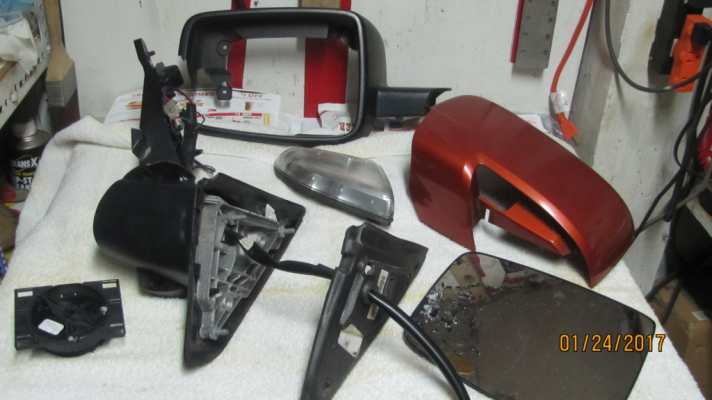

GTyankee
Nov 2, 2020
12,391
17,459
El Cajon Calif. 92021
3.0 ecodiesel

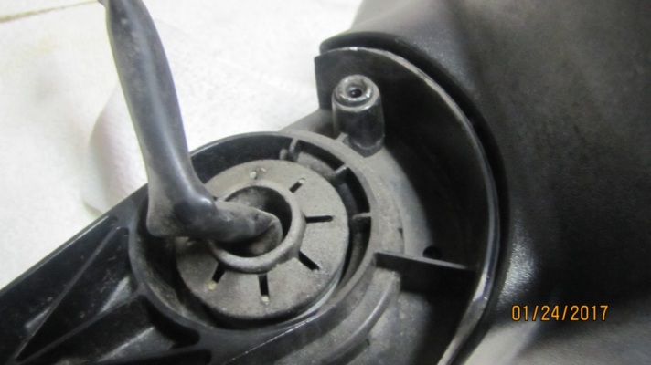

Look at the bottom of the tilt motor
Then look almost dead center on the bottom
That thing that looks like a slot, is a clip that holds the puddle lamp in on the earlier 4th Gen mirrors
Now look just to the left of that clip, do you see the the Red & 2 Blue wires that are almost hidden.
All of the mirror wiring comes up through the mirrors swivel point
