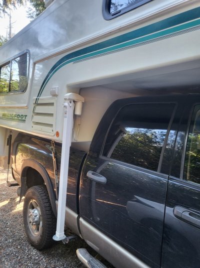

Camper wouldn't seal down past the top of the bed rails thought right? So the back of the cab is still exposed between the bed. And unless the camper seals to the back window there's even more area to get rain in.
Like this?

Yeah I suppose if the rain is moving sideways it coukd get in there, but it's still a covered area from above, as the camper bed goes over the entire cab, so just seems unlikely that it would create such a big puddle in both sides over one night...
