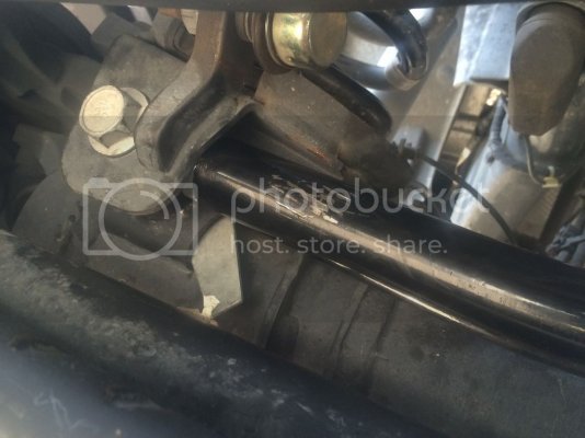

Bar is on... What a difference. It drives very well, and it's nice not having more tire hanging out the drivers side fender! The alignment was spot on still except for the steering wheel needing to be adjust back to center.

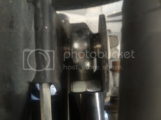

To anyone who cares if you're installing one... The instructions say to grind on the track bar mount on the axle to get some extra room for the jam nut to move as the suspension cycles, but there was no need on my truck. The jam but is so far inside the mount it wouldn't hit anything.
The high misalignment spacers on the axle side heim needed to be shaved down about 1/32" to fit in the axle bracket. Other than that, it installs easily. My final measurement was 39 3/8" eye to eye with the 2.5" RCX level.

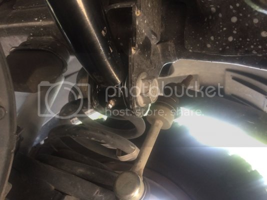

Now the good stuff...
This is the one you can see the misalignment spacers on the axle end heim. This is looking straight up under the axle.
Don't mind the pipe wrench bites in the powder coating... Lol
Greaseable frame end
Well made bar that clears everything nicely. Id like it to be straighter, but hey... Can't be perfect.
