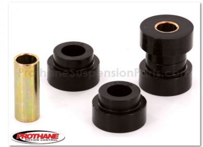

How the hell did you get the bushings installed into the shock, removing the old ones no sweat. After lots of cussing and wanting to throw **** I gave up, any help would be great. lol
Cut them in half. :favorites13:
Like these:

After trying everything including pressing them in I ended up cutting them like this. Works perfect!
I cut them the other way where it leaves two halves you insert from either side... but I don't think the way you did it will be a problem.

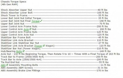

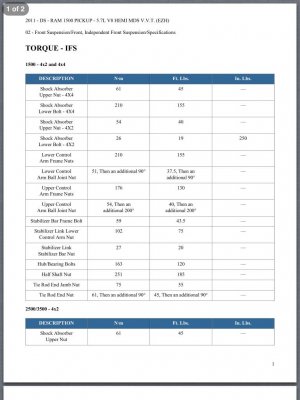

Torq Specs:
