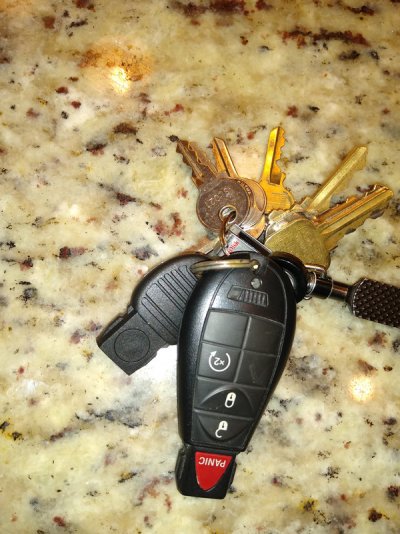

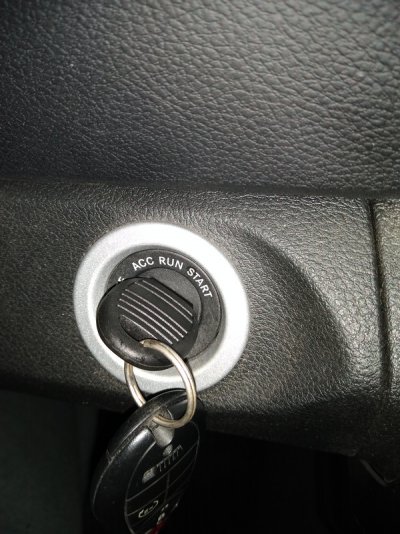

But the little things it can do are badass too. Like my mini-key.
The fob key bugged me. It sticks out too far. I bought a cheap base model key on amazon, cut the blade off and programmed it.
It only sticks out about an inch.
