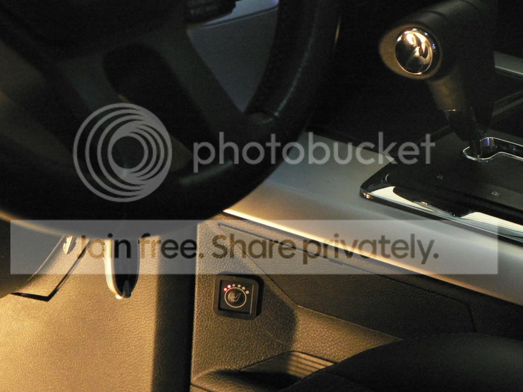

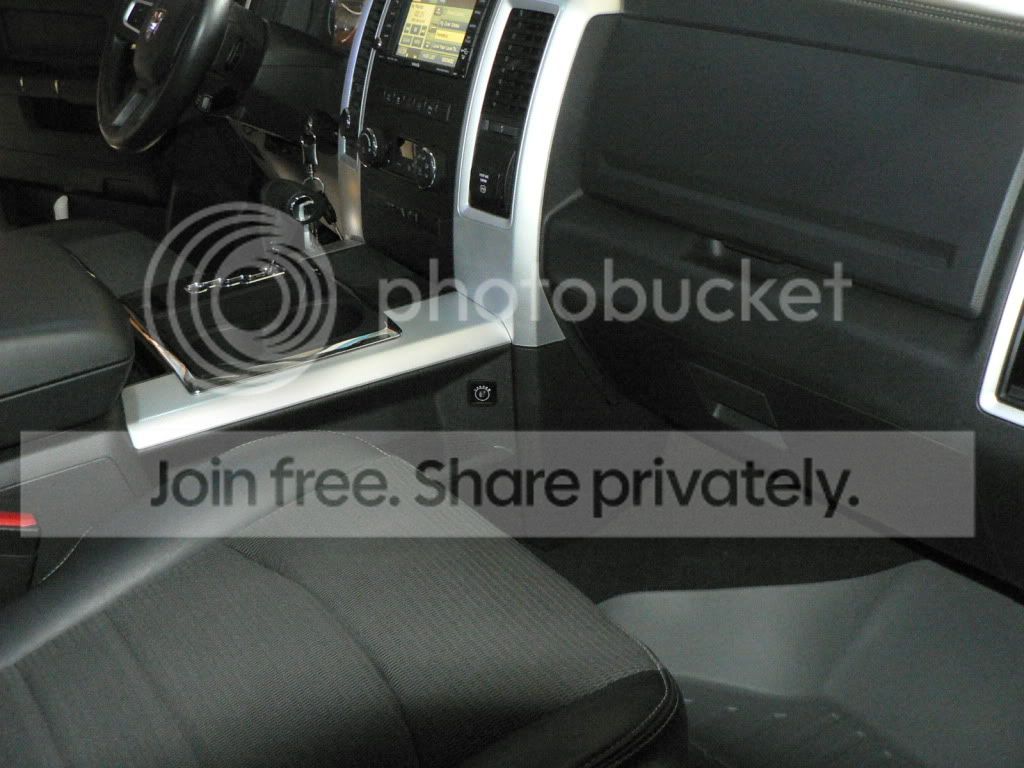

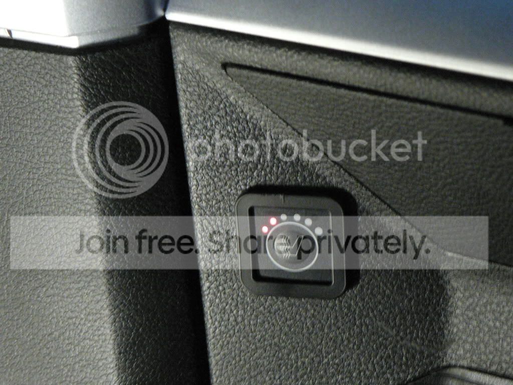

I have a Ram 1500 (SLT) with the center console (floor shifter).
I am installing heated seats, and from another post I was impressed with the location of the switches - they are mounted on the lower part of the console, both on the driver and passenger side.
Visually they would be in the front of the 'pockets' of the console.
Like this:
My question: 1) how can I gain access to that area in order to drill the holes for the switches?, and 2) access necessary to install the wiring from the heated seats to the actual switches?
Anyone with other suggestions on the switch locations is welcome to chime in.

I would say just accessing the drivers side from under the steering wheel would work. I did some work on my 2010 and there is plenty of wiggle room down there. You don't really need a switch for passengers side, just put two switches next to each other on drivers side. A passenger can always just ask you to turn it on. And usually there is always a driver when the passenger side is seated. If you insist on the passenger side I think you can remove the glove box, maybe give you some access.

Thanks, I just need to determine a 'simple' way to gain access.
I am seriously considering having the work (installation of the heated seats and associated wiring done by my dealer.

Look on any stereo removal site. They have all the answers to get the console apart.
Search RBZ radio install. There's a PDF there that's too big for me to place here.
This is what the PDF is called:
RES_REQ_REN_RBZ_RHB_RER_RHR_MyGIG_Installation_Guide.pdf
Page 8 Shows how to get it apart. Maybe you can get power from the lighter, but with the amount of power drawn, you might want to go somewhere heavier

Many thanks! This is what I was searching for regarding this objective.
Now, time to find a 'shop' to do the work - way to much for this activity to be (acceptably) accomplished by me!

Just looked on Flea Bay. There is one seller that has a PDF on the install. It does get the power from the cigarette lighter.
Looking at the documentation, I also like how the switches are set up on the console vs. the dash as the instruction show.
Here's the link to the PDF:
http://starparts.chrysler.com/info/default/k6860447.pdf

One suggestion (via PM) was to use the 'switch' panel below the radio (where many trucks have the RAM 'insert' cover.
On mine the insert is replaced with 'switches' that came OEM. I would consider that location, as well as my original one (in the picture above).
