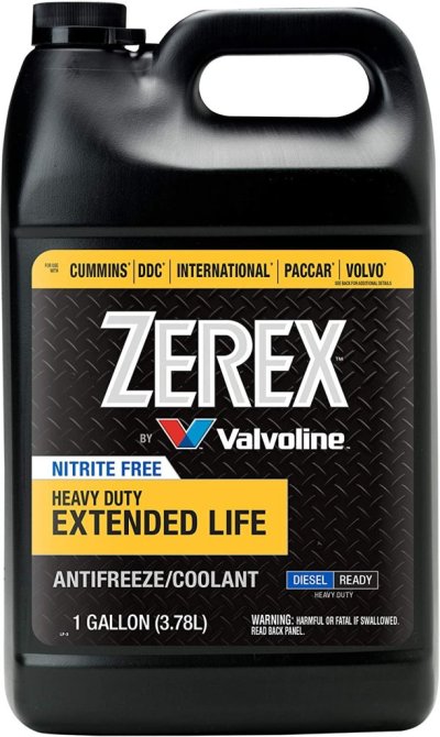

If you dont have a lot of rust or scale then you may be able to do a simple water flush and refill, being you have a 2015 diesel I would suggest if your not doing a chemical flush to just drain refill with distilled water run up to full operating temp let it cool, then drain the water and if its still has lots of color refill it again with distilled water and run to temp cool and drain, if that water look clear then refill with a quality OAT coolant like Mopar or Zerex long life OAT see below (I use zerex in my current 22) but suggest you use concentrate being you cant drain all of the water out of the block and as I see it I hate to buy 50/50 mix as your then paying $$ for them to premix it with distilled water. Also if ya have to do chemical flush also suggest you replace the T-stat with a new one from Cummins, dont use after market T-stat they dont always work as well or last as long as one from Cummins, and last check to be sure water pump has no leaks, if so replace, my preference is one Cummins as aftermarket dont last as long as a Cummins water pump, speaking from experience, oh almost forgot if you have a radiator cap on the radiator its self buy a new one jmho...
