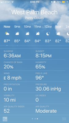

My trucks a 2017 built end of 16. Coolant is only 2.5 years old. Don’t think that’s the problem. It’s just freaking hot. Hitting mid 90s plus 86% humidity level today had real feel if 103. Looking like a bad summer. This weather is right now at 8 o’clock tonight....
