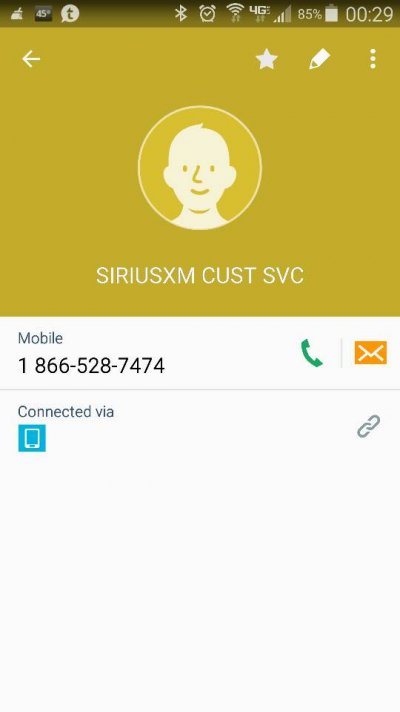

Try calling Sirius XM to get a refreshing signal sent to your radio . My truck came with the RA1 Nontouchscreen radio , I've upgraded to the RA2 5.0 , mine did this like a month ago , I called Sirius XM the walked me through a refresh , everything worked out great for me !
Hope this helps !
