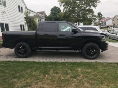

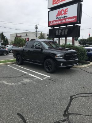

My 2014 ram 1500 leveling project is finally done! After some careful research on these forums I decided to go with the Bilstien 5100 series shocks in all 4 corners. I have the front set at 2.8 and the rears set on stock height.

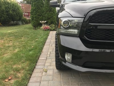

I have the stock 20x8 wheels and I was able to fit Cooper STT Pro 295/65r20 with no spacers. The actual size of this tire is 34.5"X11.5". No rubbing whatsoever.
I also put a Spintech 9000 exhaust on the truck and deleted the resonators. YouTube link is

Nice truck, but then again I'm biased to a clean black truck. Lift looks good.

Looks good, I was thinking about 285/65's but those 295/65's do look sweet.
